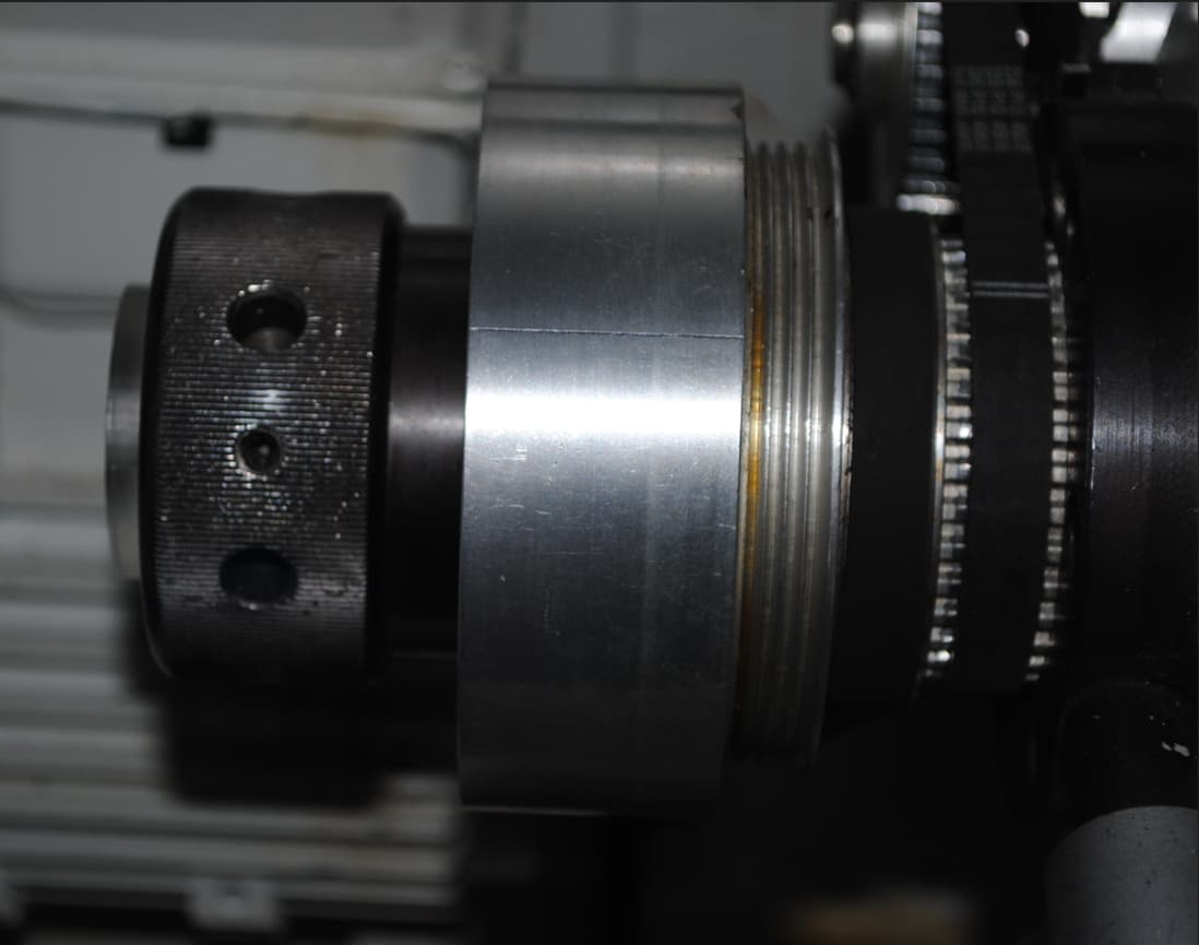

Our 3 year-old 8L has done well for us here at school. But as we start this year, I’m finding the tube that I slide in to screw onto the 5C collets is harder and harder to use. Am I not cleaning this enough/right? (I thought I was.) Is there a special oil/grease/anything that I’m supposed to be using? I’m close to having to have a “persuader” needing to be employed to put in and take out finished, on-size material (brass and aluminum) that never had this trouble before. Anybody else having this problem? Any ideas? I can’t let the students deal with this too much, or the “persuader” will be inappropriately large and swung un-skillfully. Help!
How are you cleaning the inside of the spindle? Maybe a large bottle brush and some solvent is needed if there’s chips or coolant or whatnot in there. Also I’d measure the OD at the end and a few other points to make sure it hasn’t expanded due to some ham-handedness in the past.
We’ve just been using a clean rag and some way oil. Always running our fingers in there to find the “nub” to align the collet. This is definitely a situation that’s gotten worse over time.

I think you are talking about the draw bar. They don’t last forever. Less so when people who don’t own the equipment use it. I would bet that the threads are getting stretched. You might be able to put a tap in and repair them but I don’t think the draw bar is too expensive.
Hey! I don’t think it’s the drawbar, but good idea! My collets are getting stuck before they ever even get to the nub for the slot alignment. Before the threads of the drawbar even can thread on to the collet. We’re trying to stone around the collets very gently to see if there’s any bumps or burrs.
Do you have any off-size collets that don’t get used much? If those work ok, then you know it’s a collet issue. If those don’t work well either, then it would look more like something in the collet holder. I wonder about the condition of the alignment pin.
The alignment pin is…sub-optimal. We have worked on cleaning it up but have mostly focused on the sides. Now that I think of it, the height of the alignment pin could be some of the issue. We had a very old set when we bought the *l and the first purchase after it showed up was a brand new set of 5C collets. The less expensive options, for sure, but they work in all of our other 5C fixtures. It’s time for the “Micrometer Refresh” lesson for my 2nd and 3rd year students, so we’ll check all of them and see how far off they are.

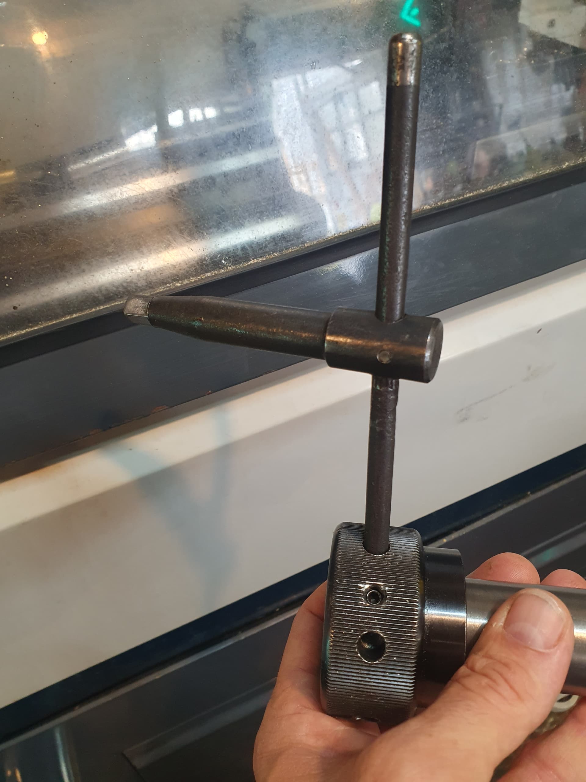

Has anyone got a better idea than that knucklebusting spanner wrench for tightening the drawbar?

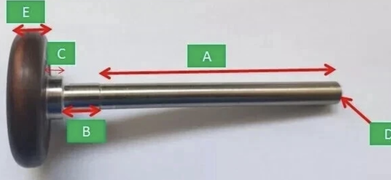

All my old watchmaker lathes have a knurled handle on the end of the drawbar.
They are only 8mm collets though so someone will have to do the math on the handle for leverage.

That’s very similar to the 8L drawbar, except the handwheel on the 8L also has holes around it’s “tread” face that allow for a spanner wrench to be used. What comes with it is the Captain Hook style spanner (I’m sure there’s a correct name for that, but I’m unaware of it). I’m thinking of switching to a half-circle with a pin in the middle style as I think this would minimize the slip/busted knuckle events. Maybe the fact that we’re having to use the wrench so much is telling of the very issue that I started the thread about in the first place…namely that it’s too hard to insert and use the 5C collets in our 8L. If others aren’t having this same problem, maybe it’s just our machine, or our way of running it.

@Jason_Rye once you have a chuck, the chuck key handle fits nicely in those holes and offers a much lower chance of busting knuckles. It’s also easy to over tighten doing this.
