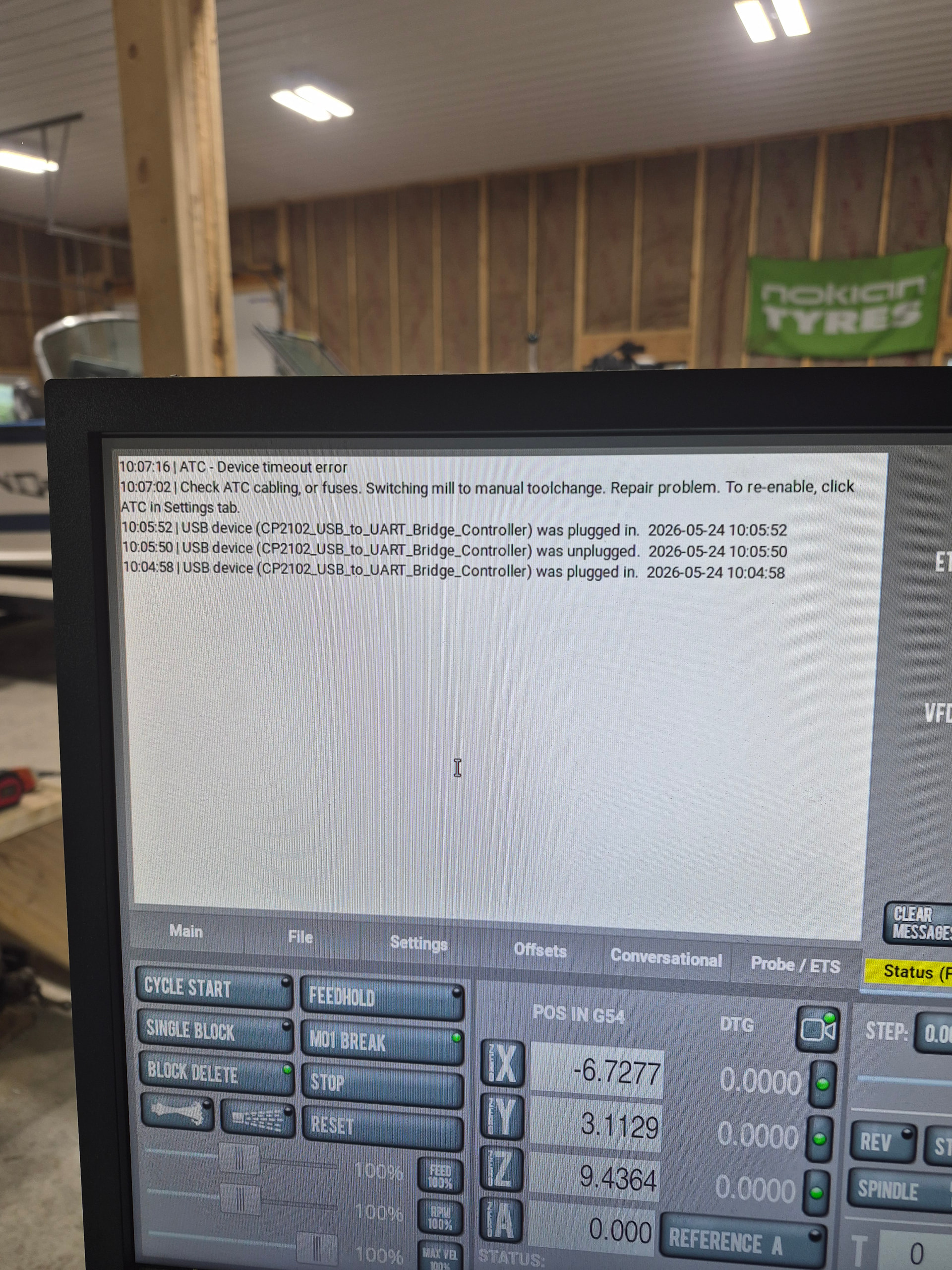

The atc is connected to the machine control via USB. Have you identified that cable? If you unplug it and reconnect do you see status messages in PP Stutus page?
Once you reconnect you have to re select ATC in the settings tab

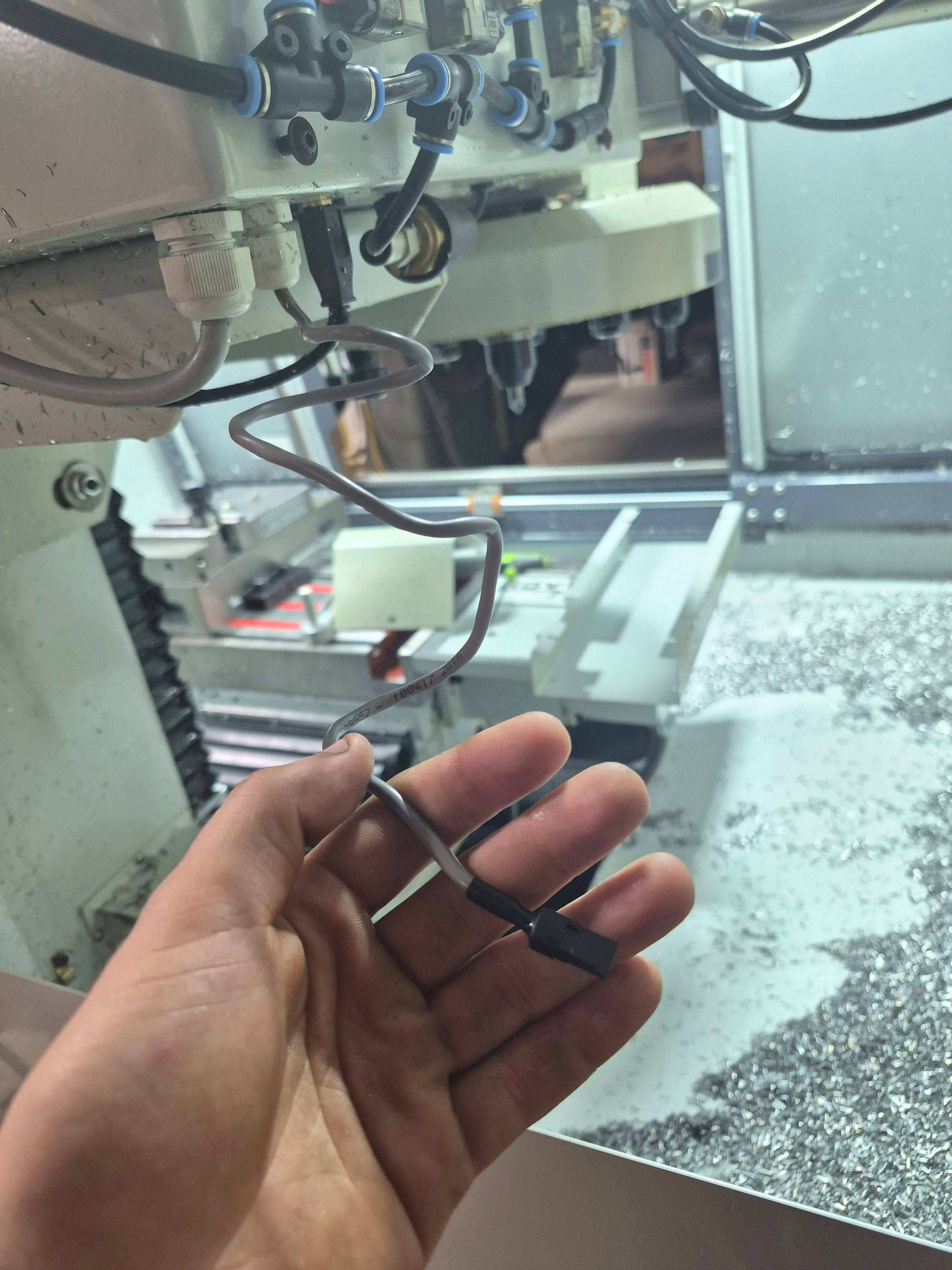

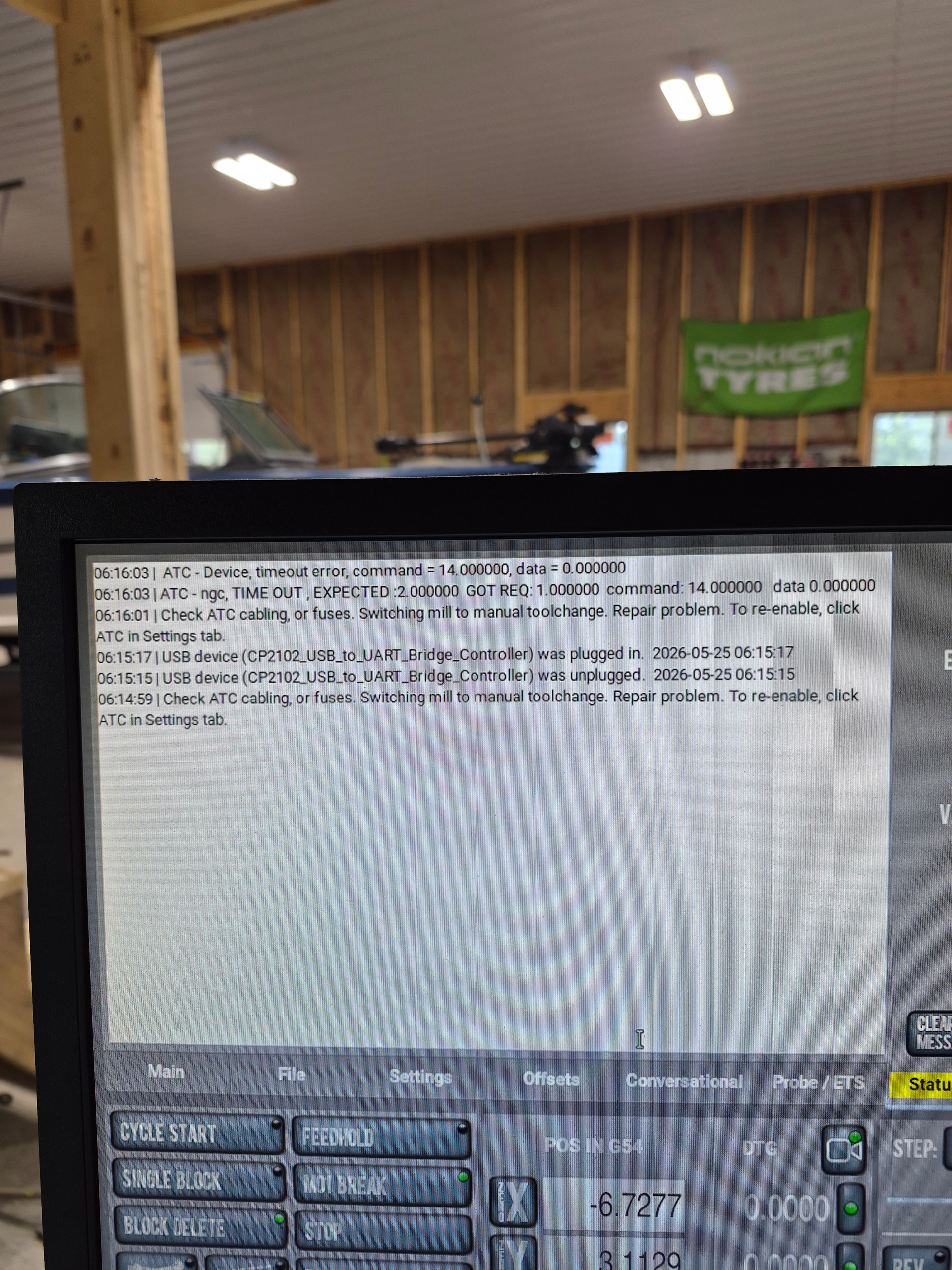

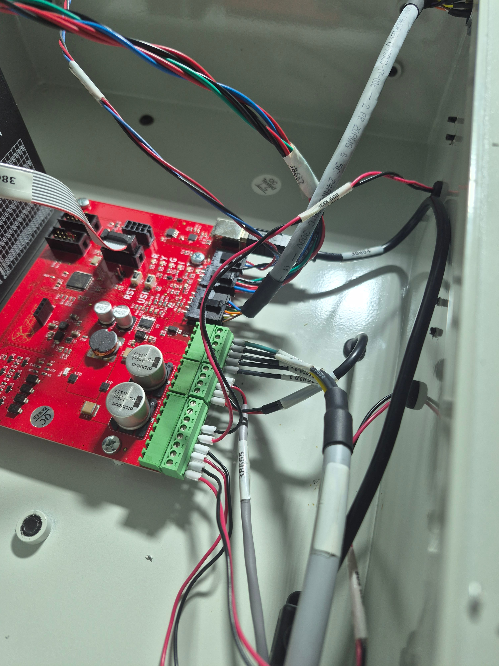

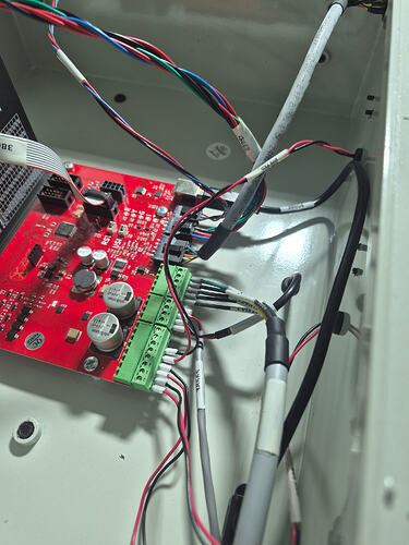

Ok, so when you unplug the USB from any of the connections, such as to the gigabyte controller, or up in the atc box they all show up on the pc screen, then I tried switching it back to atc, and tried to reference it, and the check cabling and wires error comes up, I noticed the one wire that is just hanging there and could not find any place for it to plug into, even though it is plugged into the board[the small grey wire going into the 4 prong green box in the middle] not sure what that would be for, the servo motor controller has power going to it but no leds light up on the board. When I disconnect the large grey wire from the board and reconnect it there is an audible click somewhere like their is power going through it. No errors come up when I disconnect that wire.

That Wire is to hook up a foot pedal. Don’t worry about that.

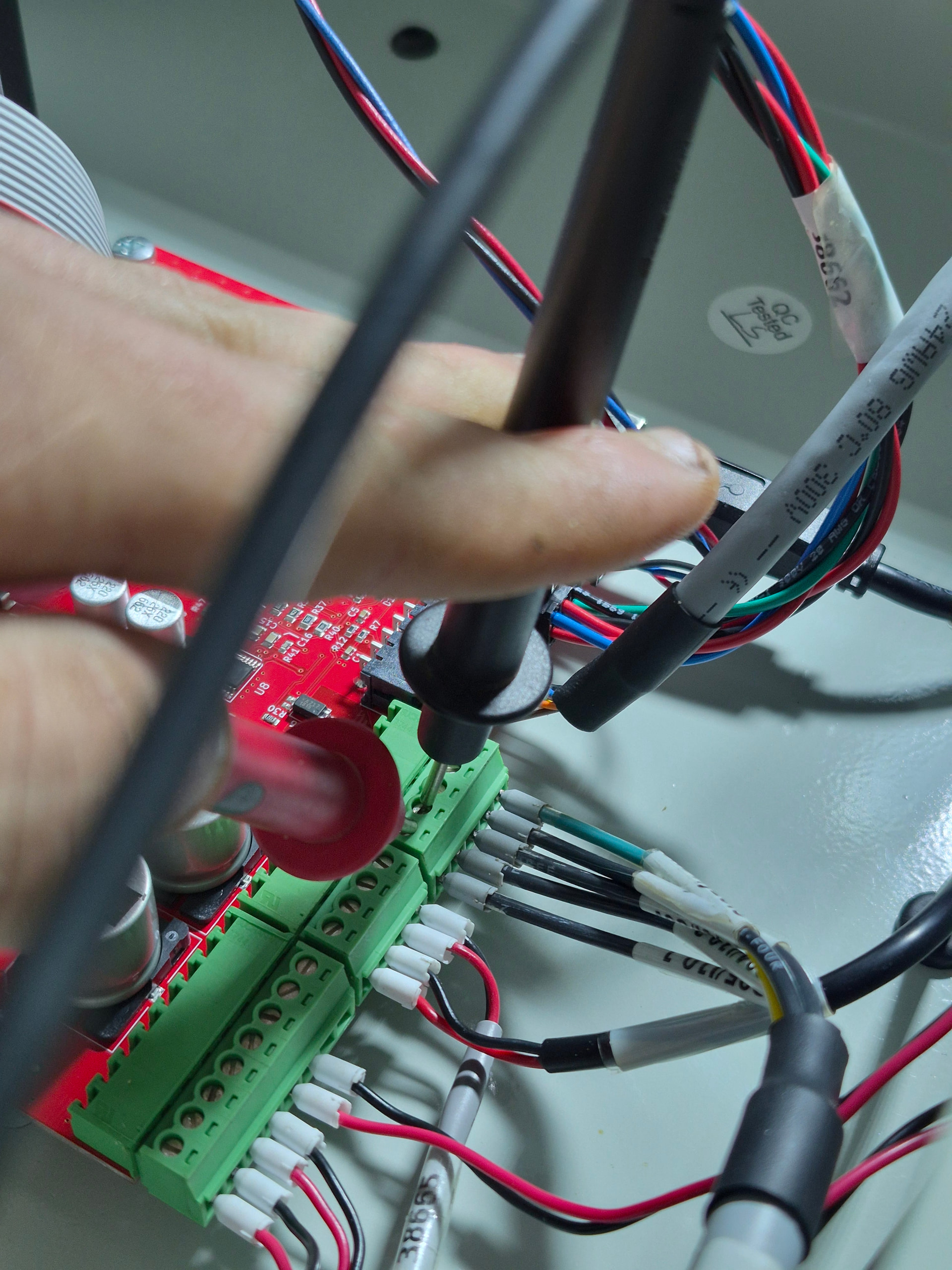

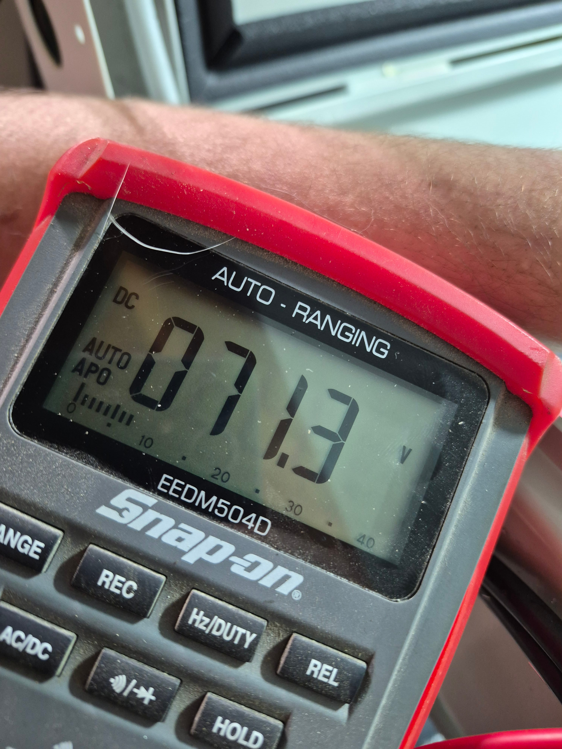

Ok, so i unplugged every single wire going to the atc and cleaned them all, the fuse listed in the atc trouble shooting guide has continuity, and I have 68+vdc across wires 205 and 204. I tried switching to the atc, then shutting down the machine and restarting everything, and the atc tab was still there when I started it, but the carousel was not showing, anyway I tried to ref it and those are the errors I got on screen afterwards.
That error seems to imply a communication path problem to the ATC, not so much a loose wire. How does the 770 ATC connect to the controller?

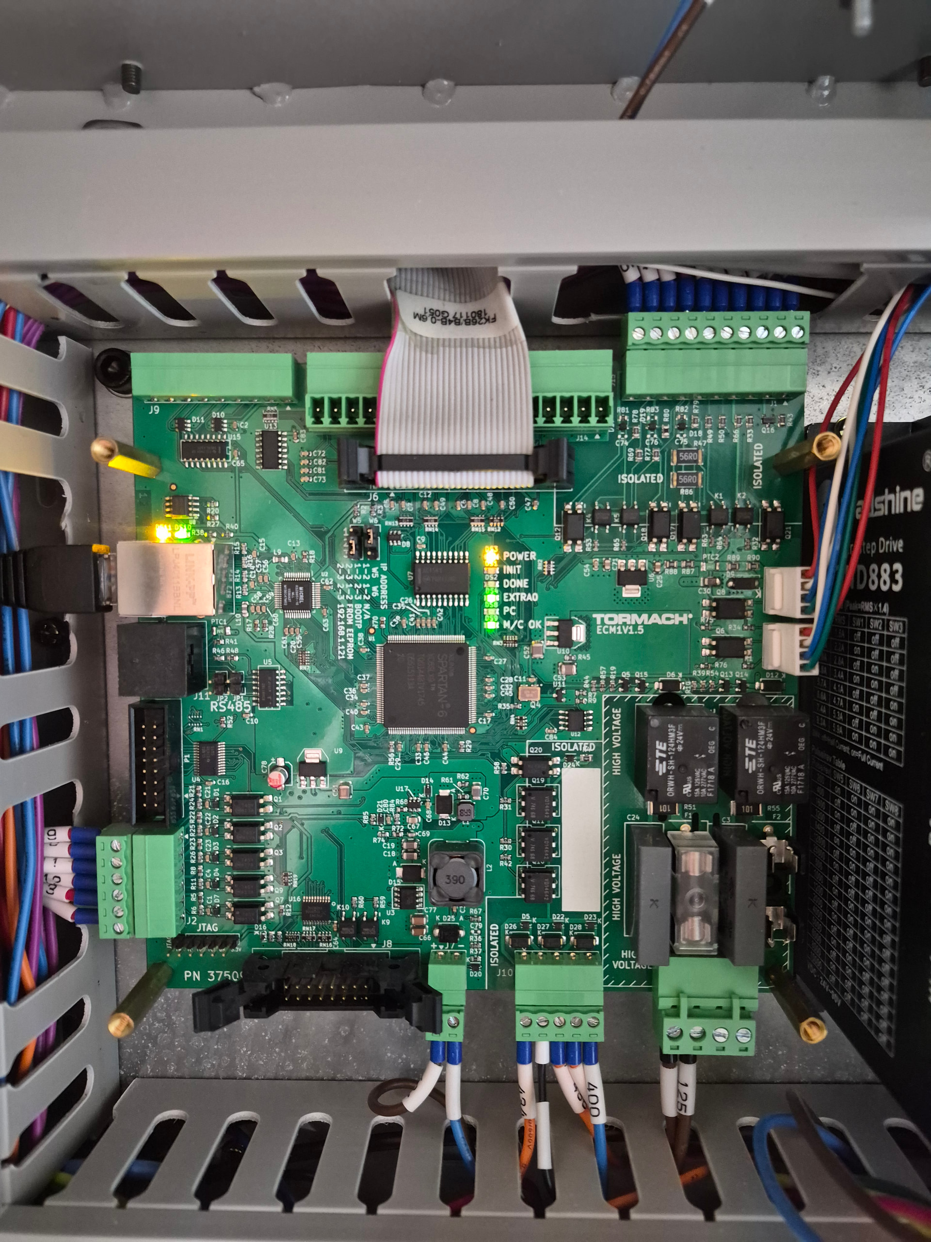

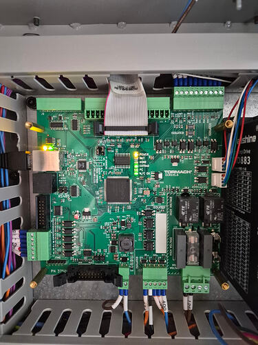

What LEDs are lit on your ATC board? I’d suspect the voltage regulator blowing, it was a common issue with the 1.7 boards like you have.

There aren’t any leds lit up on the atc board currently, but the stepper motor controller does have power, which that goes through the atc board anyway.

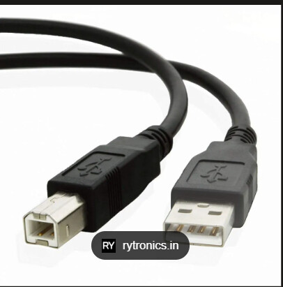

the 770atc connects to the controller through two usb cables, I believe it would be considered a USB-A to USB-B or a USB-1 or USB-2 to USB-B, Not exactly sure of the diffrence between the A and the 1-2, this is what it looks like though, which the controller is recognizing the fact that it is being unplugged or plugged in, just that the ATC tab in pathpilot doesent show up, im not sure if replacing the cord would help since i still dont know whats causing the fact that there arent any leds lit up on the board, which i wouldent assume the USB-B cable would be the power source for those lights.
USB has power and ground sources at the PC/controller side along with the signal wires which are allowing it to establish a connection to the CP2102 chip on the ATC board. The CP2102 then talks over the serial side to the ATC microcontroller. It’s a game of pass the message. The message gets to the CP2102 but not to the ATC microcontroller (or the microcontroller is reporting failures).
The ATC board requires external power for the rest of the circuitry to interface with the USB to serial chip. This is likely why you have this issue (similar to mine) where the PP controller PC “sees” the ATC controller as far as the the USB-Serial CP2102 chip but there is no response from the microcontroller or response from the peripherals (inputs/outputs) the microcontroller expects to communicate with which need the secondary power supply (70V in your case) and PP determines it is a a no-go and disables the ATC.
Norman’s advice is probably the best diagnosis at this point given you have no LEDs on the ATC board.
