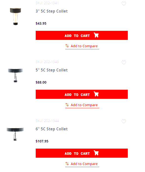

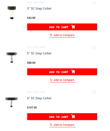

It looks like Mike Henry provided about the only off the shelf solution
These can be machined with an desired interior diameter then used in 8l to hold a large diameter part.
Looks like sizes up to 6” are available.
Anyway I might order a couple of these just to have on hand. I tend to move to the mill when I run into problems like holding large diameter material. This might be a decent solution to keep those projects on the lathe.

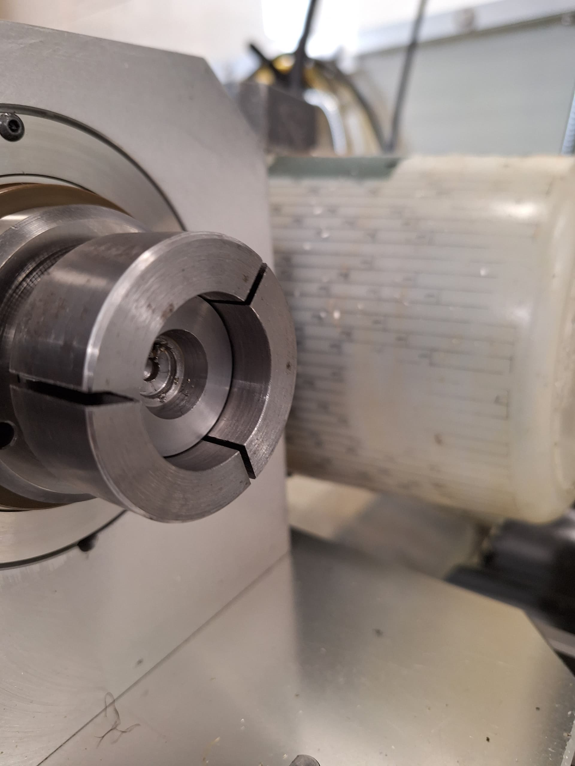

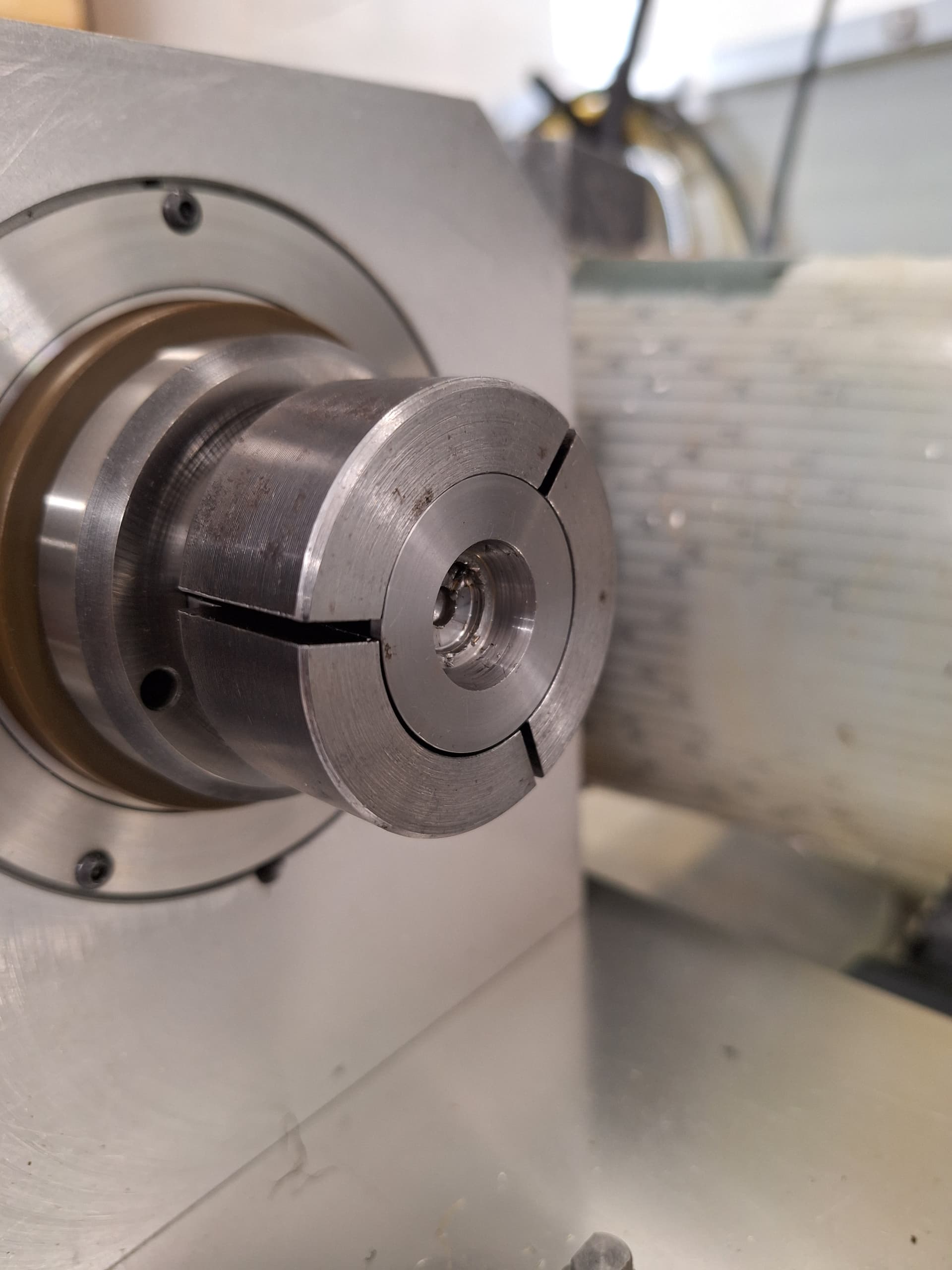

One other thing to consider when boring out a step collet (AKA pot collet) - turn the bottom of the bore to sharp corner or, preferably, put a small undercut at the corner so that the work sits square to the Z axis. Most carbide inserts have a nose radius that will leave you with a small radius at the bottom of the bore. On the 1-1/2 and 2-in discs that I’ve turned, the ~0.250 long disc is only held by ~0.030” of stock on my 15L. In my manual lathe I was holding 3-in diameter brass by about 1/8” stock and taking 0.050 cuts in X and Z.
A little undercut.
Great tip.

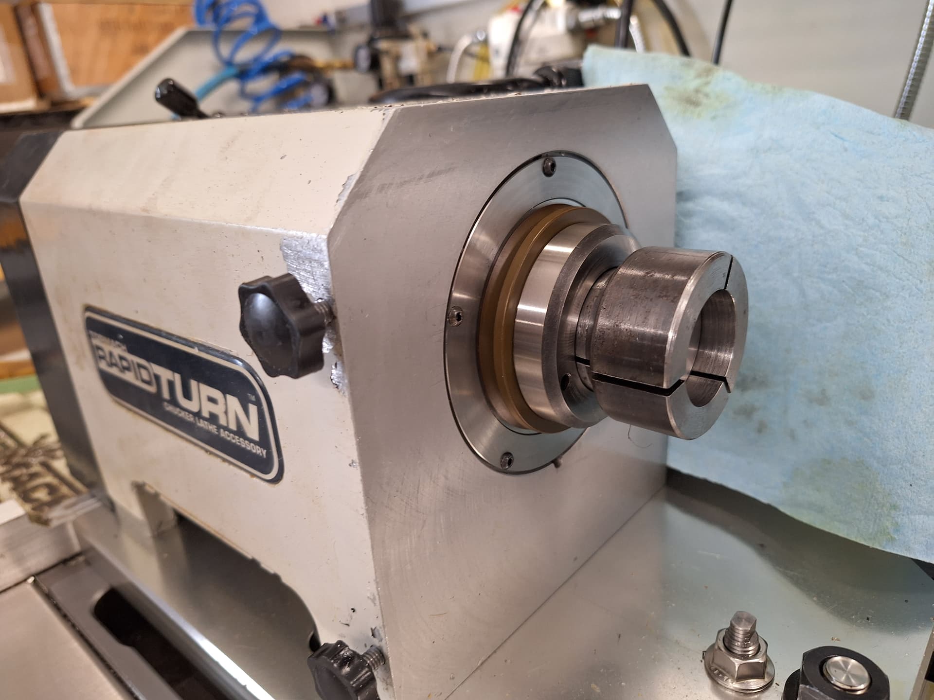

I use step collets on my RapidTurn. This is for a part from 1-1/4” stock that I do often. I added a spring loaded ejector to help with unloading and chip clearing.
That is beautiful. So there is no issues with the collet jaws spreading without a closer ring?
I just crank the closer down to get a good bite. I have noticed wear on the taper, I think because the collets are softer than usual to allow for machining. We used really large ones at a previous employer 4-5” on a HAAS TL-1 toolroom lathe with the regular closer. My workpiece is Acetal (Delrin) and is soft but slippery. On occasion I pulla part out of the chuck when it hangs on the boring bar, often in the first few before I get my arm “calibrated”. (The RapidTurn doesn’t have a closer, it just tightens up with a tommy bar). Like any setup, you may find you have to reduce your normal feeds or DOC to stay within your grip and/or power.
I have seen people on social media put a steel hose clamp at collet edge to add some clamping pressure.
Careful with that. That will add off center weight to your setup
