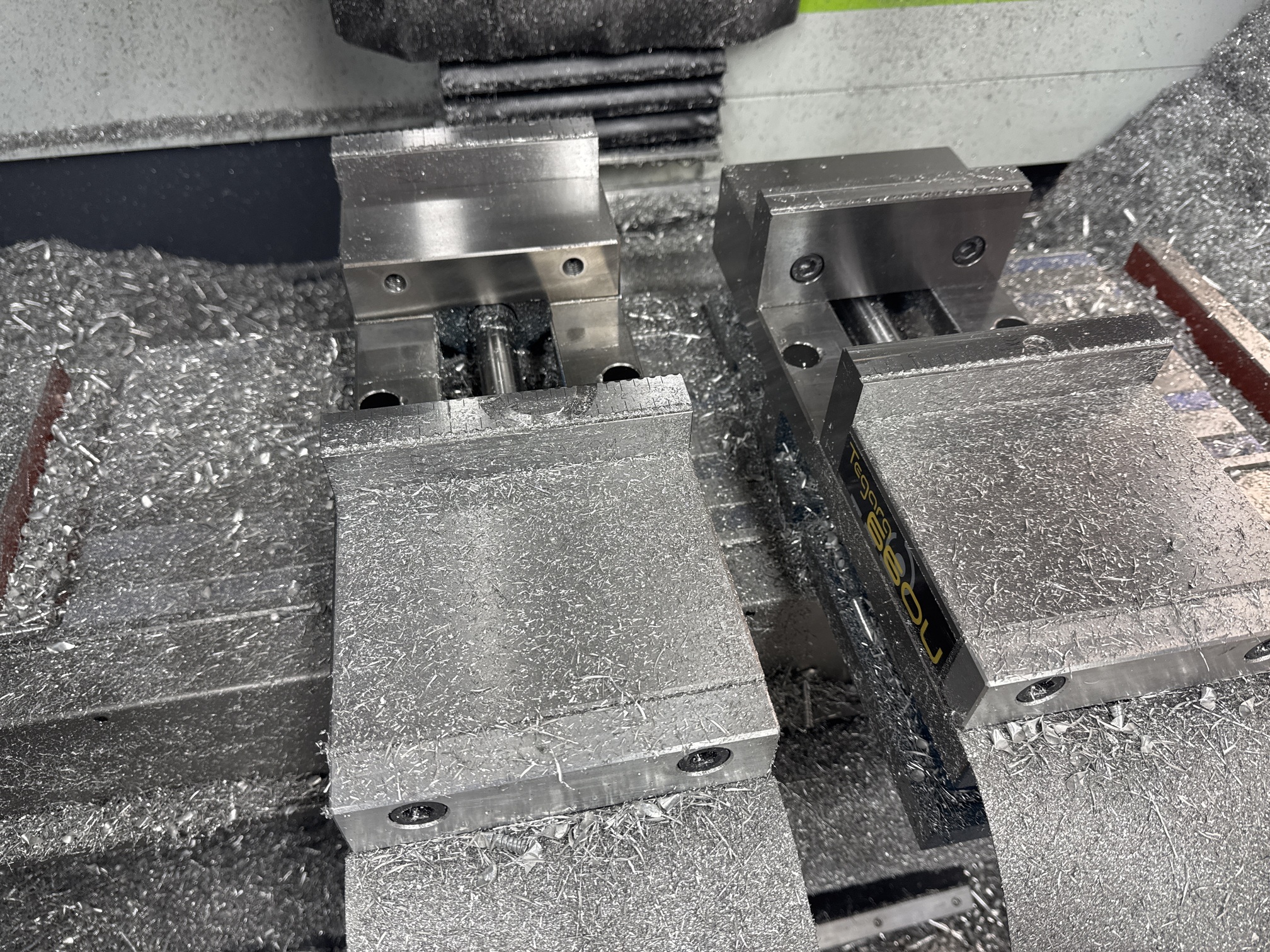

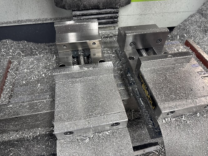

Matched pair of Tegara 6” 660U’s
These are very accurate … within .0002
Comparing the beds or top of the fixed jaw
The vises have plenty of room in Y without hitting the enclosure
I machine many parts that are large and use both vises… parts that use the entire XY envelope
And they mount with no clamps which is helpful
Ed
Holy crap I thought I had a lot of swarf to clean up.
It’s was much worse then the pic showed
Just finished cleaning
Two 40 gal garbage bags full
About 30-40 lbs worth
Maybe 2 weeks work
