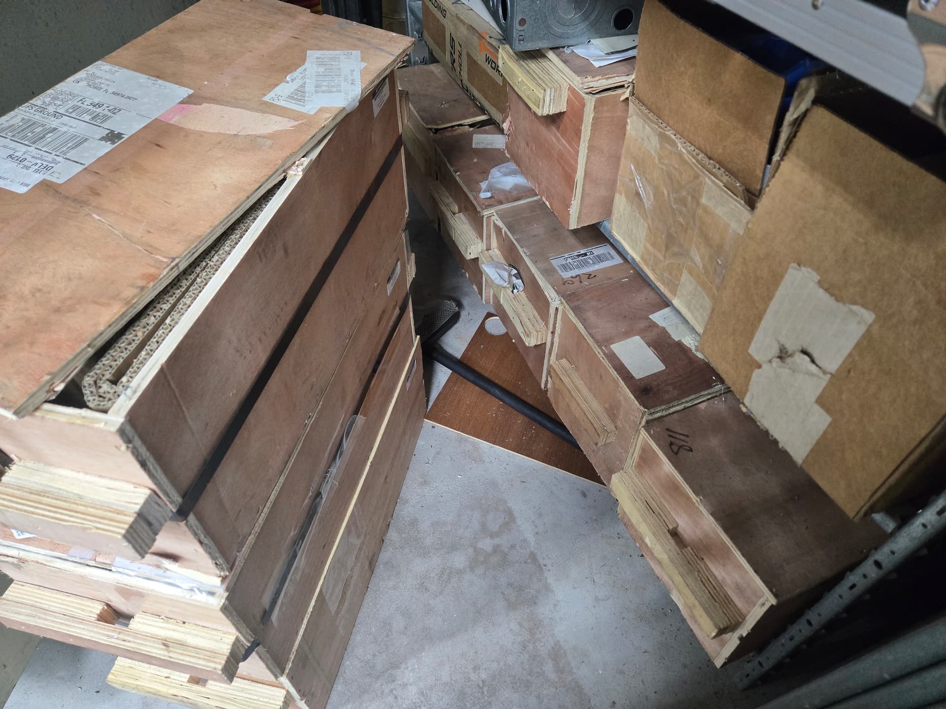

Any change you would be willing to sell one of your failed spindles ?
you have quite the collection
