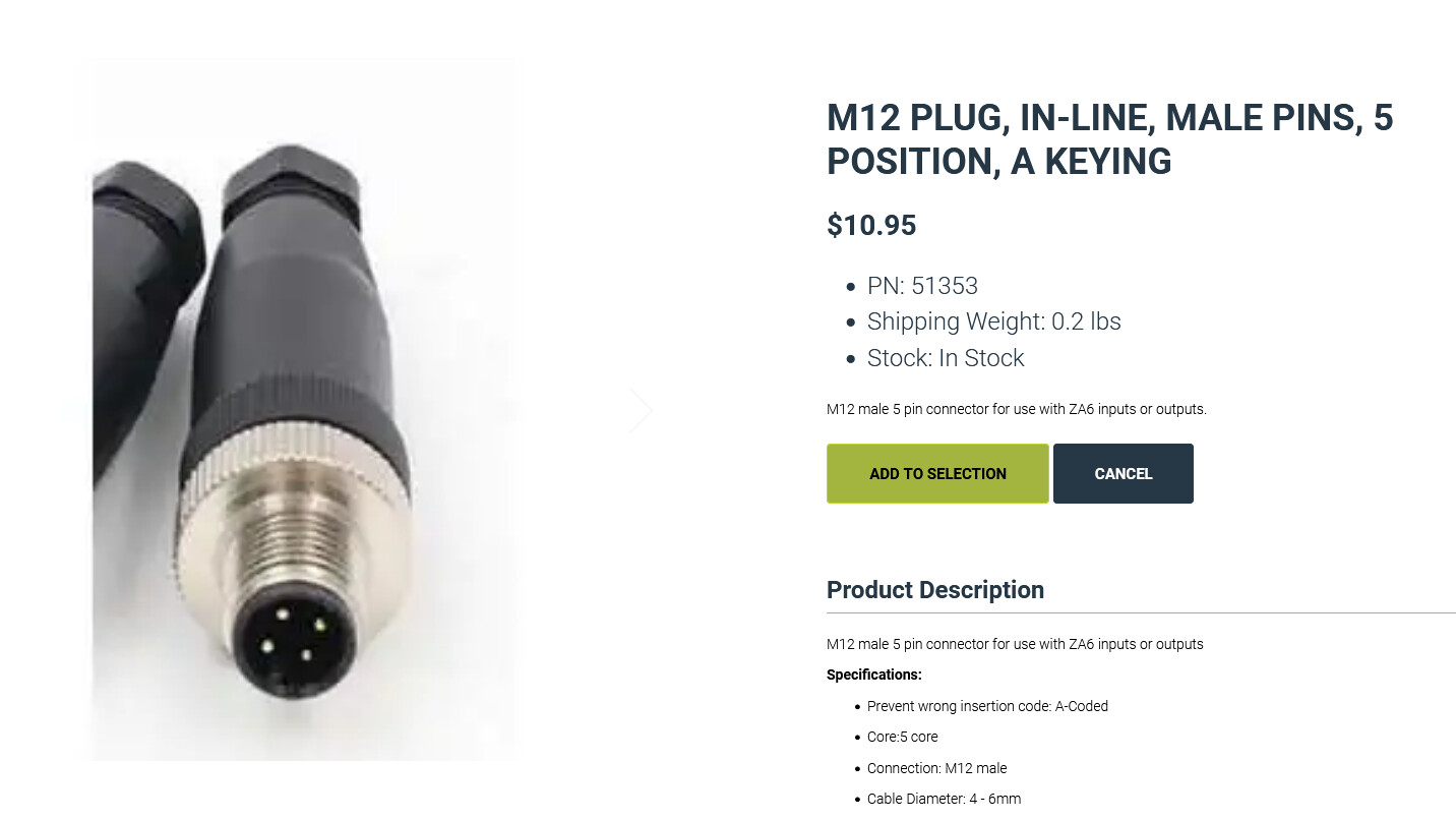

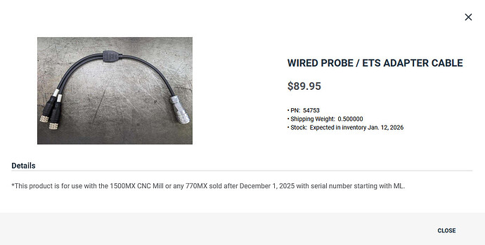

Probing - As for wired probing on the 1500MX, that is now an option and wasn’t when the machine launched. The reference to the ML SN’s is in relation to the 770MX as this kit will work on all 1500MX machines. If you want to use your own probe then you will need the y-cable (54753 $90) and M12 connectors (51353 $11). These aren’t directly accessible on the website and we can get them added to your quote from our end.
