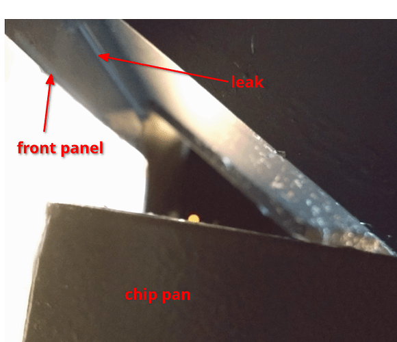

Finding leaks can sometimes be quite tricky. It took me a long time to locate where the 1100MX enclosure was leaking, even though it was right at the front next to the coolant tank. I only discovered the source after removing the front cover of the coolant tank—it was leaking between the front and bottom panels of the stand. The paint had started cracking and peeling off at the welded seam, and apparently, it’s no longer coolant-proof. I added a piece of sheet metal to the front of the coolant tank to redirect the leaking coolant back into the tank.
