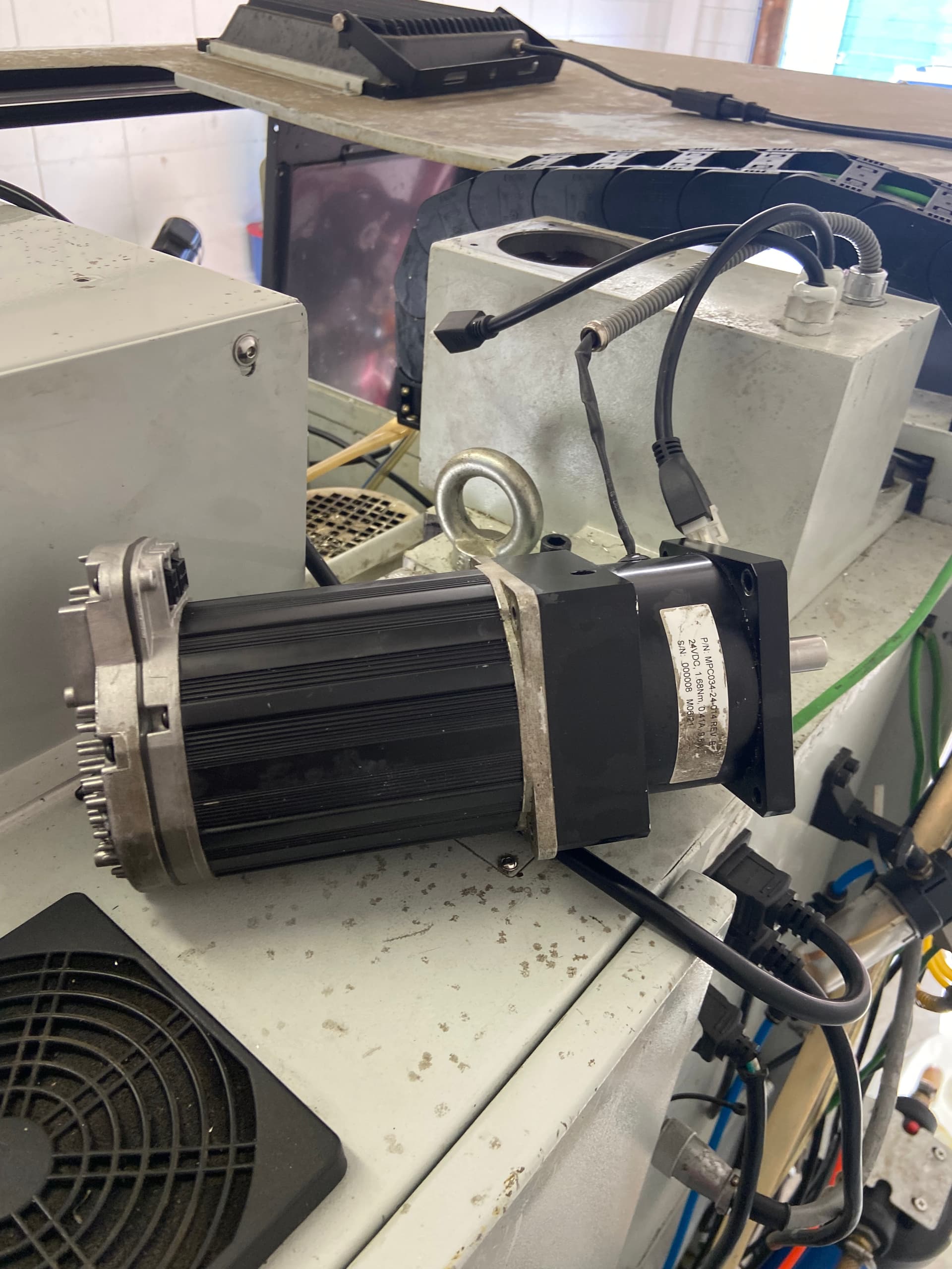

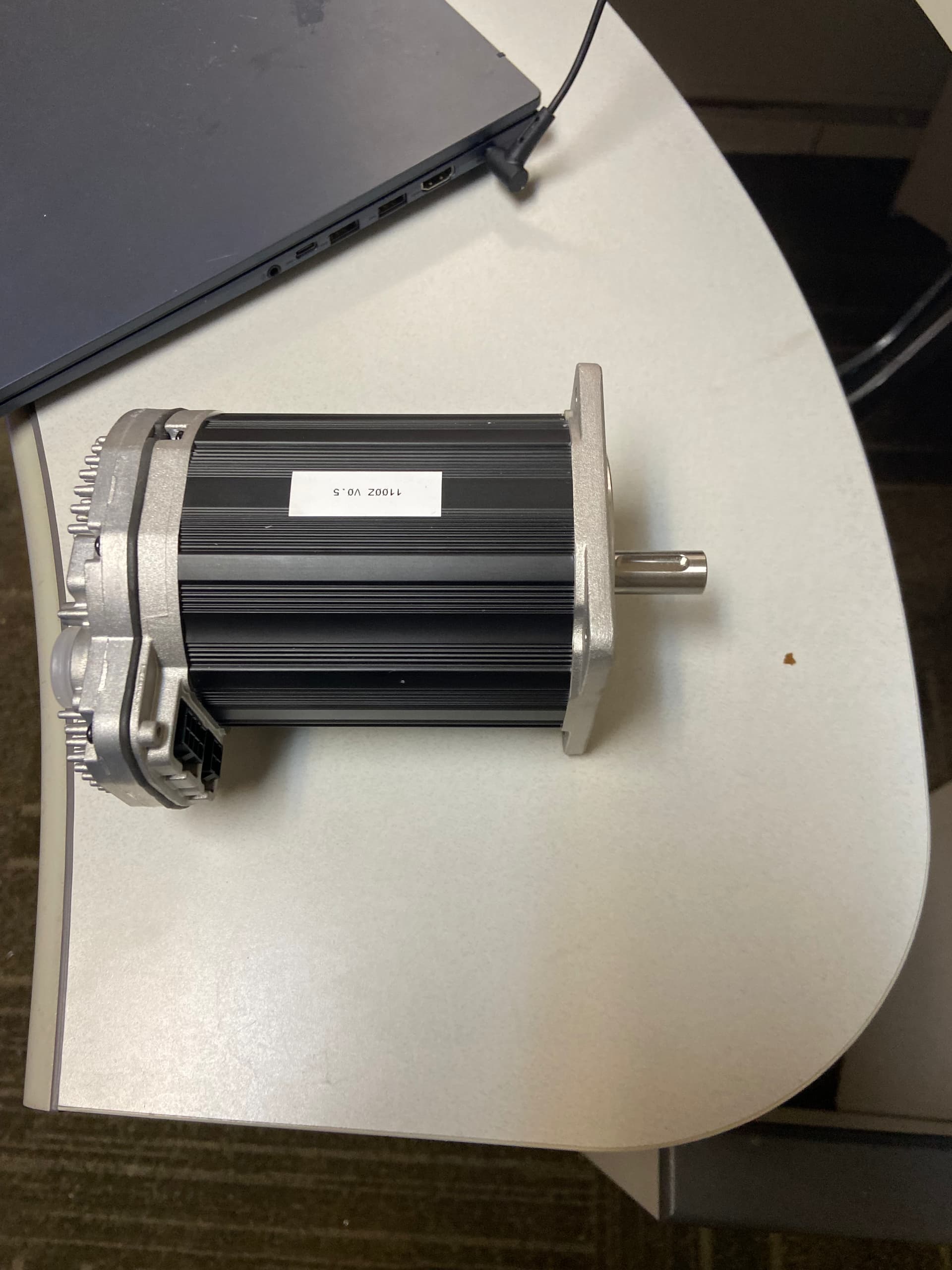

Tormach said it may be the servo. I ordered a new servo wow it costed more than I thought it would have. Order it Thursday morning and payed extra for next day delivery. Monday at 4pm I received the servo. Im having trouble removing the Z brake from the old servo so that I can install the new one. Removed all four bolts and backed the coupling bolt off as much as possible. The brake seems to be stuck to the servo.
The 1100mx doesn’t have a Z axis brake.
The first pic is just the servo and the second is the servo with the brake attached. Come to find out my issue was the coupling that connects the servo shaft to the brake shaft. There is a small accesses hole on the brake to tighten or loosen the coupling
