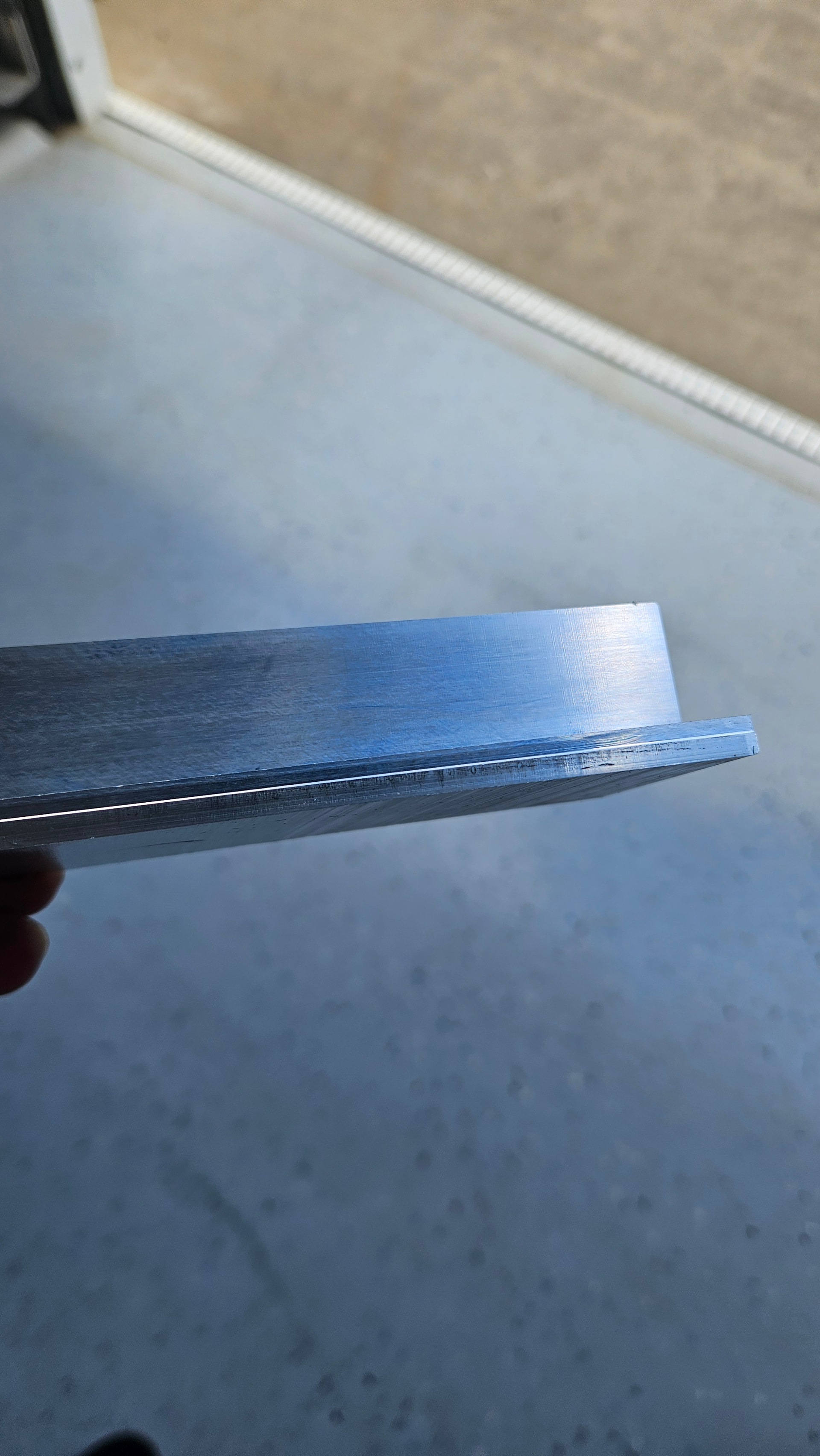

There are a number of factors that could account for why im having issues. But the table moves smooth and free, it should hold. Ive talked with clearpath & tormach they are reluctant to help out other than basics. Thats why I’m messing with settings. The fine wall finish is what im trying to improve right now like I brought up in the original post. So far my 440 does better at wall finish. The 1100 holds dimensions better, but I have to run extra passes to clean the walls up and I dont think its as good as my 440.

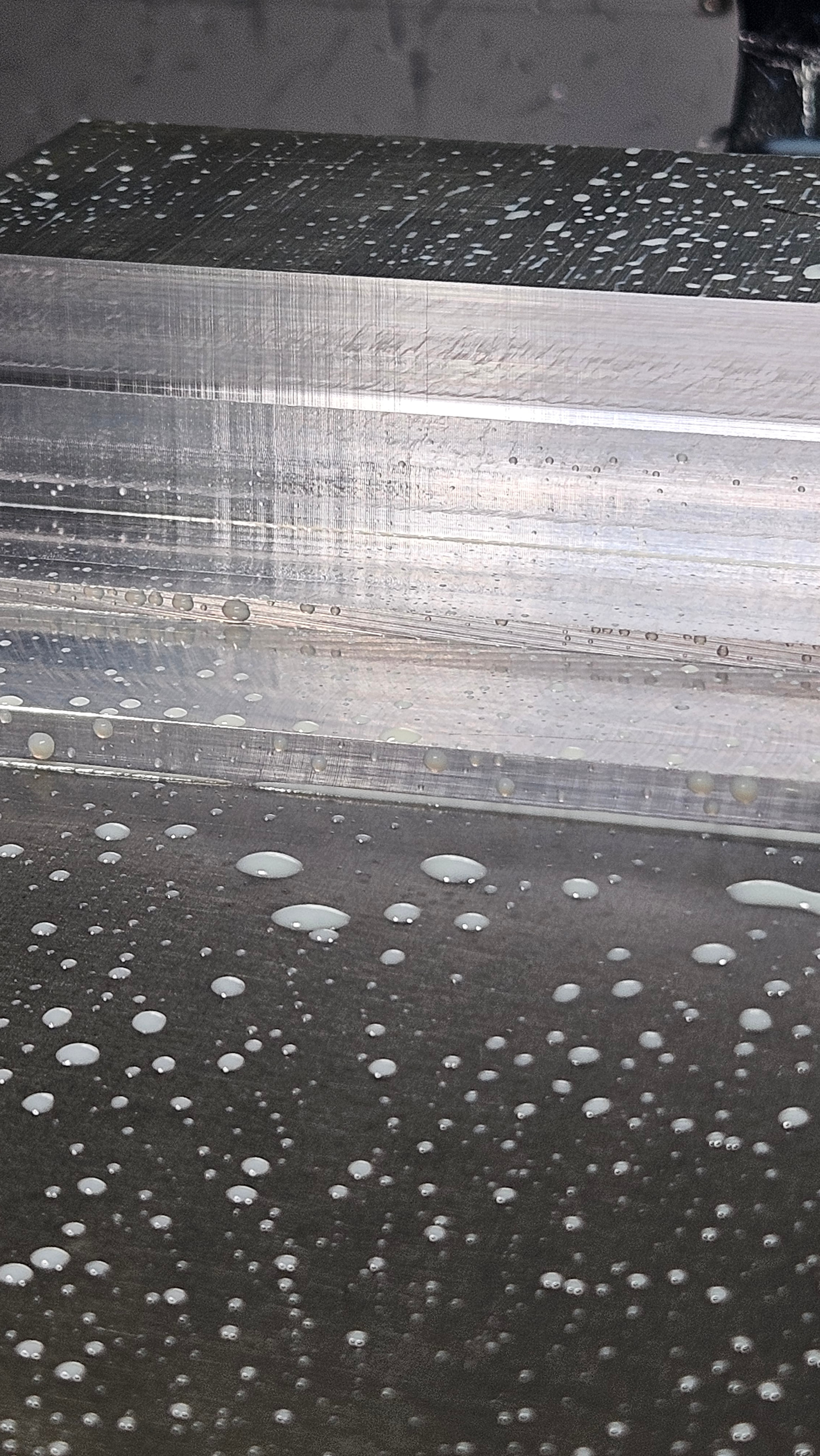

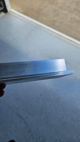

So I made some progress and I think I will let this ride for now. I need to get using the machine not working on it. I have posted some before and after. Prior to this I did go and adjust gibs 10 ways to sunday. I also replaced the AC bearings. And pulled gibs and cleaned and did a contact test.

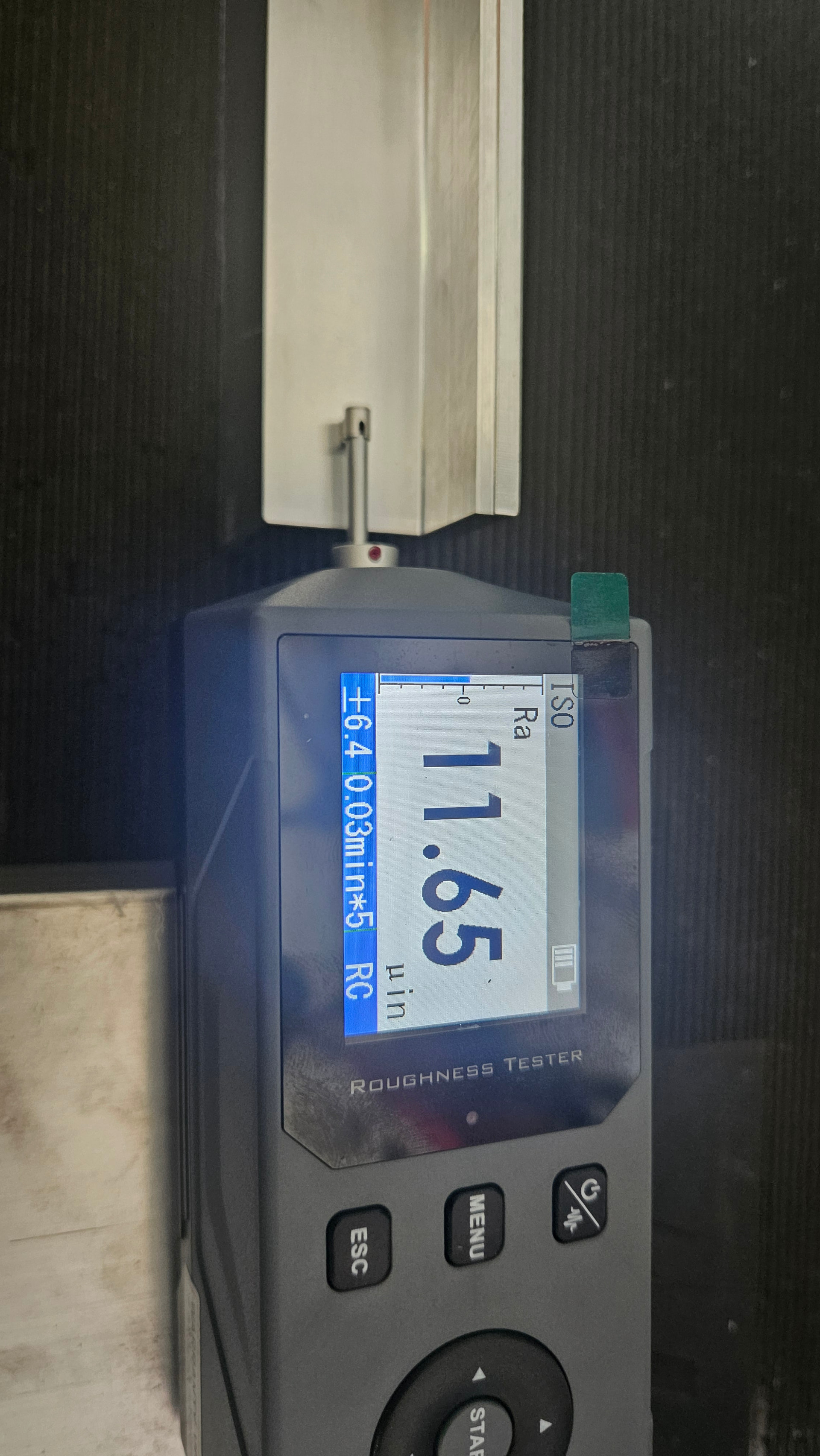

For me the solution was to do an auto tune in the servos. I figured if I dont like the auto tune, I will put in the old config files. I loaded the table with all the weight I had to put on there which was 2 - 6” vises and a dividing head. I am guessing it was between 100-125lbs. I also kept the holding torque value I mentioned in previous posts. I will do some more cut tests, but at the moment I am relieved to get this far. If you squent and angle it just right you can still see some faint lines but they are hard to see and hard to feel, even with a finger nail. When before, with a fingernail you could certainly feel them. I may be a little pickier than most, IDK. At arms length I cant see any of the lines and wouldn’t even think to look for them with the current finish. Keep in mind pictures seem to really exaggerate how bad the lines are in both the before and after pics. There can be endless debate as to why I needed to go through this and so many of you have great running machines. And I am jealous of you and hopefully after some more testing I can move on and chalk this up to used machine blues.
So if you are having similar issues as this post. And there were 2 issues in this post. The initial fine resolution lines and the big bump/thump lines which I didn’t find till after starting this post. I hope this will give others some info to go on to get to an acceptable finish. I would call this finish acceptable, I would like it to be better. Meaning I see no lines no matter how hard I try.
