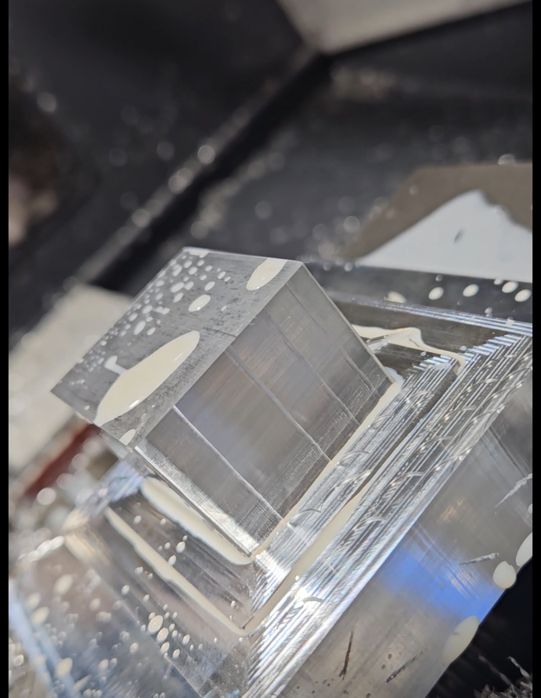

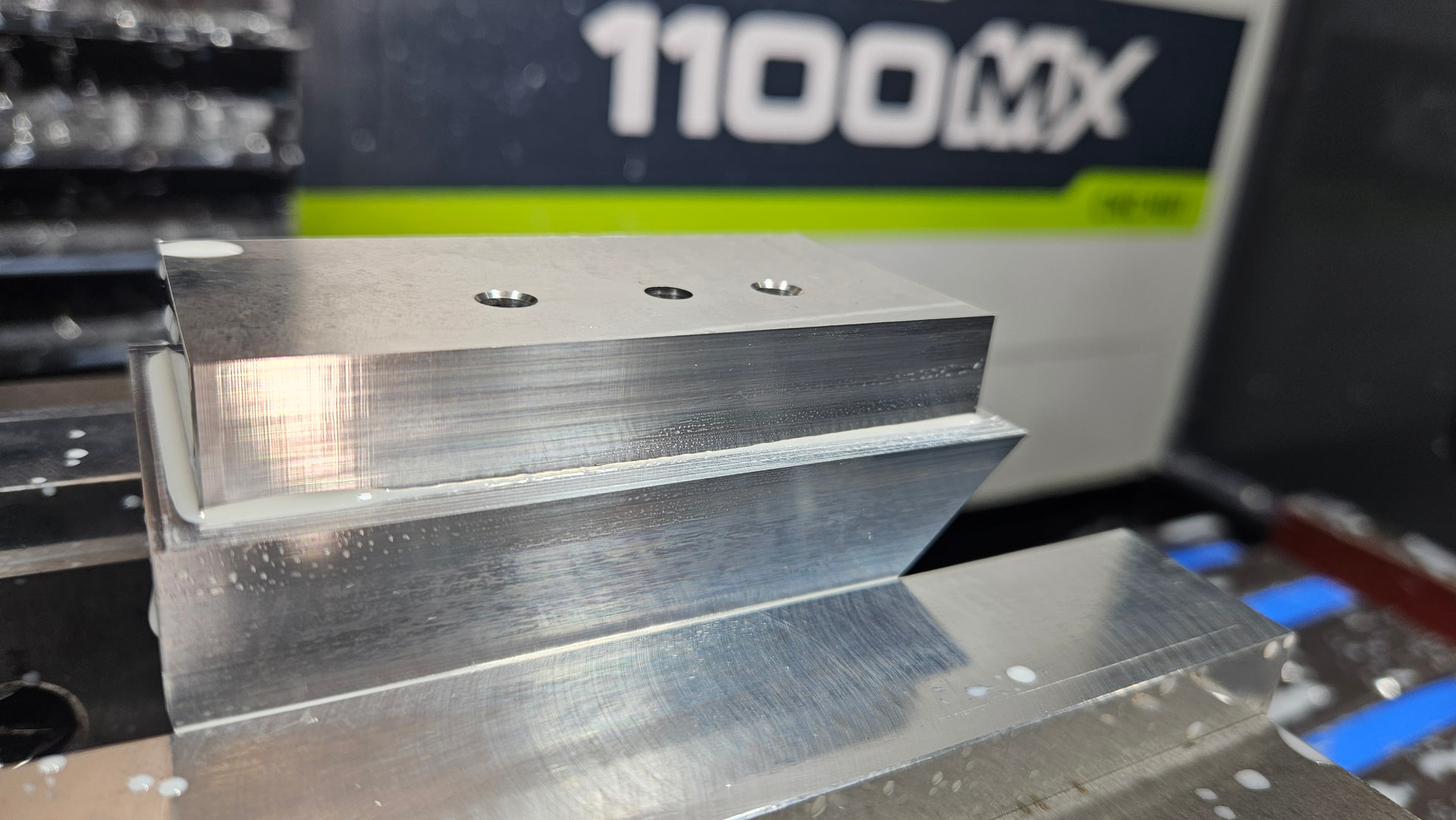

The upper 0.5 inch is the 1100mx, the lower part was from the 440. The 440 had a 3/8 end mill with 2.25 stick out and has better finish.

Those gouges are nasty
I dont think thats a EM problem
I think its either your holder/collet or the machine itself

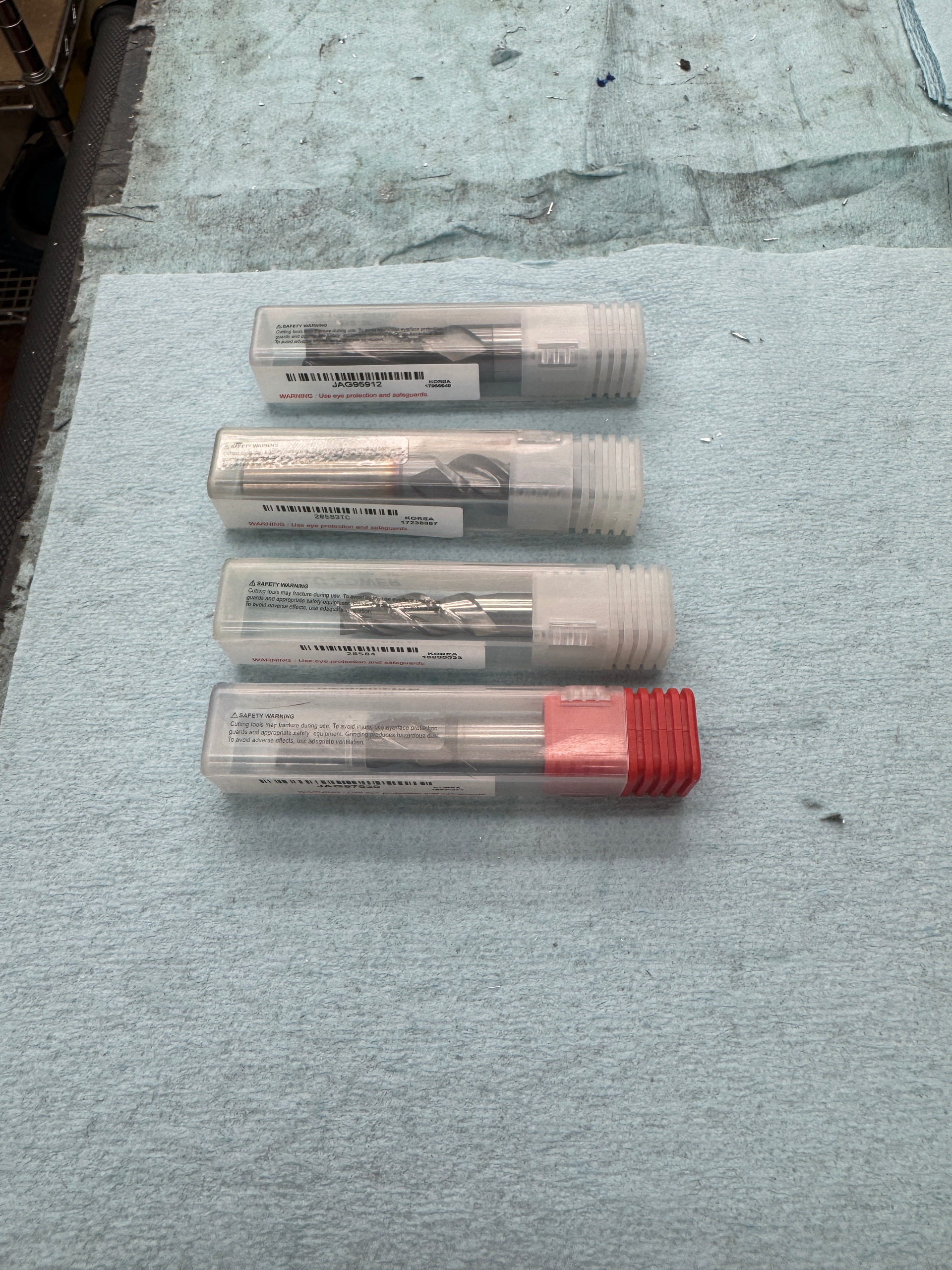

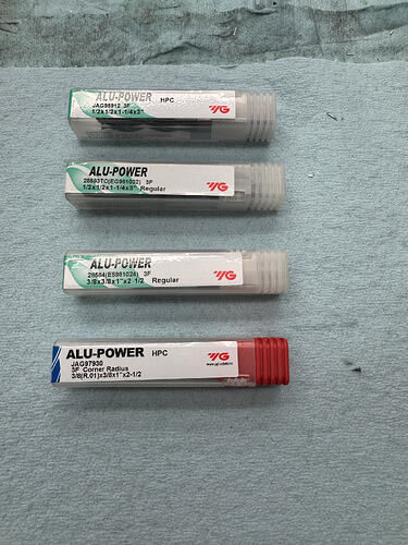

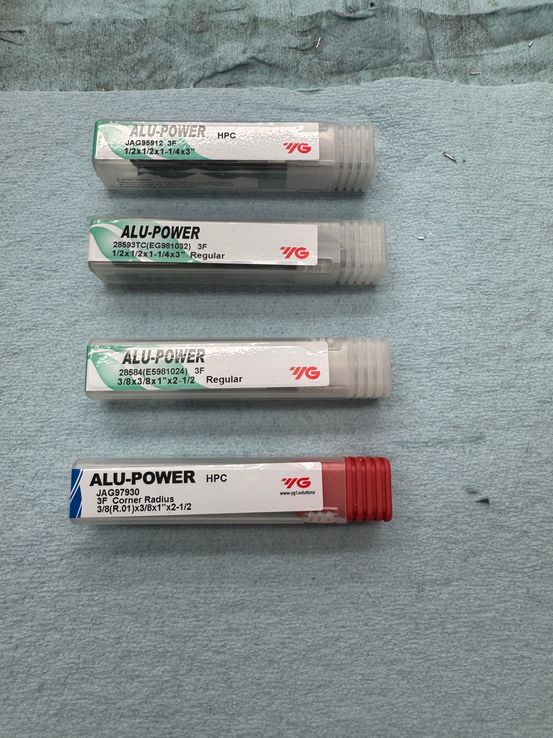

here are the 3 versions of YG EM’s I’ve used
The most expensive is the JAG… although it lasts longer with its high end coating I could not get a better finish than the TC or no coating so I use it for roughing….. the bare carbide make a great finish and I will just get those in future

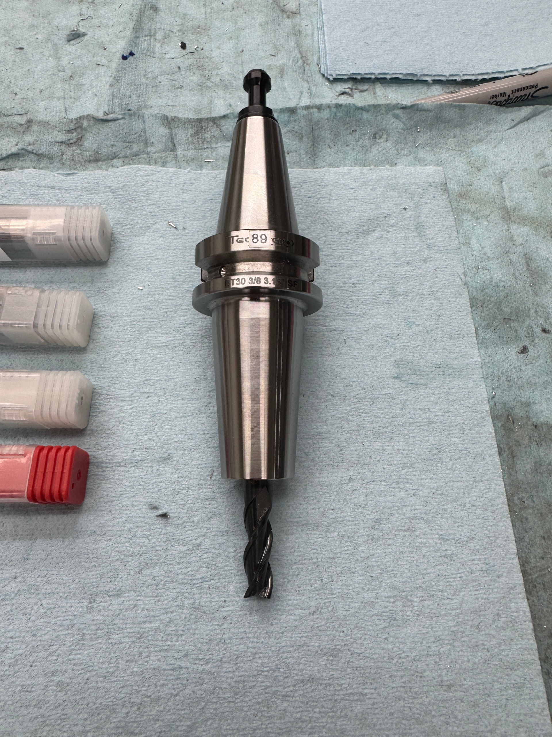

also is a Tegara shink fit in 3/8 I use these on all the finishing EM’s for low TRO and rigidity, they cost about $135 and easy to use a propane torch to install or remove an EM
