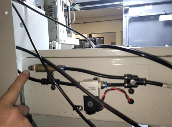

Was shutting down our 1100MX today and wanted to remove the active tool from the spindle. I clicked the “Store Current Tool” button in the ATC tab. The air draw bar released the tool and it fell. The ATC never moved.
Is this common, or is there another command that is more reliable? Is it better to go to T0 to empty the spindle?

Locate this valve on the back of your machine, and turn 1/4 revolution at a time CW, and test a tool store. Put a box under your spindle to catch the tool holder you test with, just in case. Keep adjusting until the early drop ceases.

It seems like Sam’s suggestion helped, although I had to rotate the valve CCW two full turns.
Possibly tangentially related: now when the machine’s air is low, the machine throws a low pressure code, and the ATC tool process pauses. Previously the low air alarm did not seem to be triggering.
