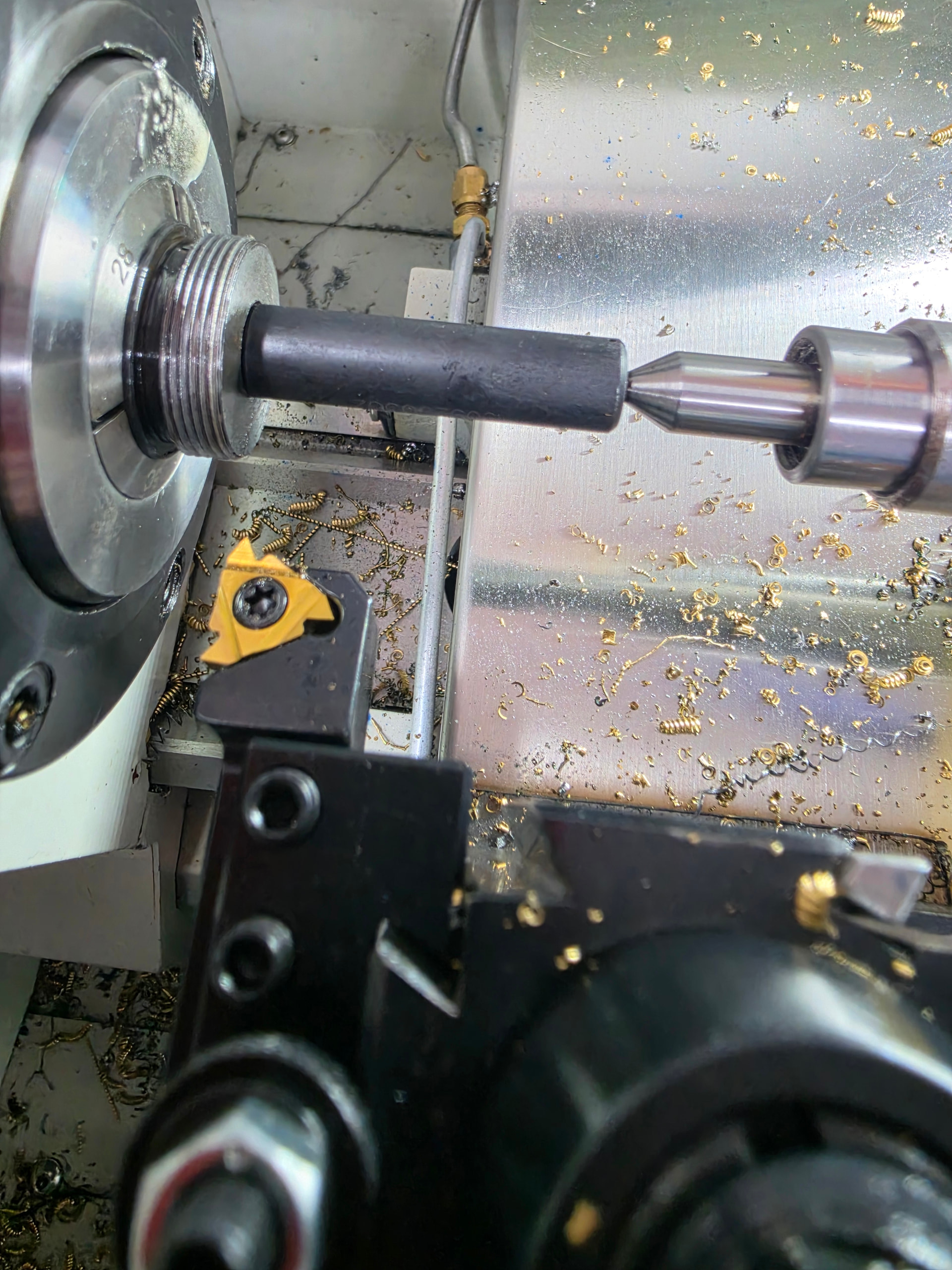

I thought I would add a little more to this post. I had to re-cut the thread on a cheap 5C collet stop. This is the method I used. The auto collet closer on this machine makes it a little tricky when using collets. For this job I used conversational to enter the thread parameters. Make sure you use a slow spindle rpm so you can stop the machine in the middle of the first pass. I set the starting diameter about .010” larger than the actual work. I then step through the program, using single block, until the threading cycle begins. Use the stop button on the screen, not the emergency stop, to stop mid thread. Be careful not to move your z position. Open the collet or chuck and rotate the thread until it lines up with the tool. With the auto closer I use the tail stock as a reference because the part will move about the same distance each time it is closed. Next carefully rotate the part until you get good alignment with the tool. You can jog the tool in the x direction to check your alignment. I use magnification and a white background to help. I usually rerun the program and stop it again to double check my alignment. Once I am satisfied I restart the program and let it run to completion. This process is a little finicky but I have used it successfully for a while now. If anyone has a better procedure to re-cut threads I would love to hear it.
