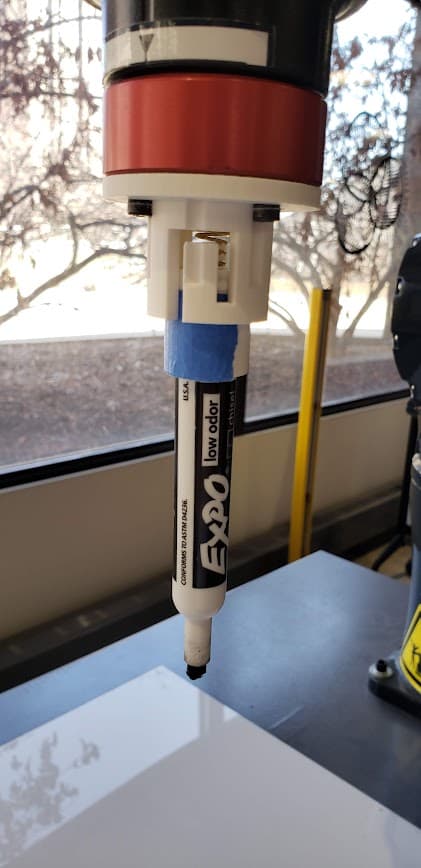

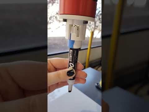

**Marker Holder**
The first step was to create an end effector to hold an Expo marker. After several iterations, I made this spring-loaded expo marker holder. It has two pieces; one flange that mounts to the ZA6 with screws and one sleeve that press fits to a standard expo marker. This allows for the marker to be easily removed from the flange screwed onto the mounting plate on the ZA6 for testing or marker replacement without having to take out all the screws. I 3D printed it and it only took about an hour on a Bambu Carbon X1:
 ![image](https://forums.tormach.com/uploads/default/original/2X/1/1f2e28055c388fac1dc9ec786cecab37636b8cf2.jpeg)
[![](https://forums.tormach.com/uploads/default/original/2X/a/a9aa8caff22935f8627af5327f20734ebb3d8fab.jpeg "Spring-Loaded Expo Marker Holder") ](https://www.youtube.com/watch?v=otqFNl3pzFg)
I would recommend that if you use a soft-tipped writing utensil (like a marker), that you use a relatively weak spring. Otherwise, the spring is not engaged when writing, and the marker tip just gets smushed.

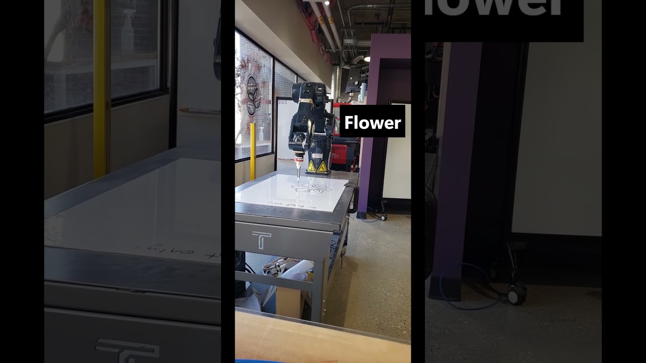

**Programming**
This was the most difficult part of the project. I started off with the SVG drawing program from @Sadiq_Wanyaka, which used the svgpathtools Python Library. I am currently unable to install Python libraries inside the docker, but I wanted to move forward with the project. So I developed a workaround. I made two Python programs. I ran one Python file in the computer’s terminal to collect data points from the SVG file using svgpathtools and deposit them in a CSV file. Then, in PathPilot, one Python script can scrape the data from the CSV without needing to install any additional libraries.
After rigorous testing, I also developed a new section of the code to choose a path blending radius for each individual path of the drawing to make every line incredibly smooth, regardless of the distance between points. I am very happy with the performance as shown in this video:
[![](https://forums.tormach.com/uploads/default/original/2X/8/820a83508b9cc96f4b4e999ced60766524580292.jpeg "ZA6 Whiteboard Drawing Demo") ](https://www.youtube.com/watch?v=-fW4kOWMlFo)
