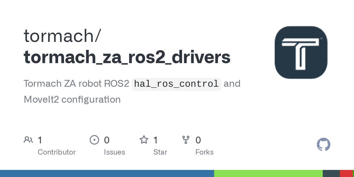

Hi Alex, thanks for posting this! After we saw your question, I cleaned up and pushed our initial ROS 2 support git repo, including robot hardware drivers and MoveIt2 configuration, but without the Tormach robot UI and TRPL interpreter.
We developed this some time back, in part, with customers in mind who don’t care as much about the UI, and just want direct access to the MoveIt2 or ros\_control layers. Hope it’s useful to you.
> **[GitHub - tormach/tormach\_za\_ros2\_drivers: Tormach ZA robot ROS2 \`hal\_ros\_control\` and...](https://github.com/tormach/tormach_za_ros2_drivers)**
> Tormach ZA robot ROS2 \`hal\_ros\_control\` and MoveIt2 configuration
