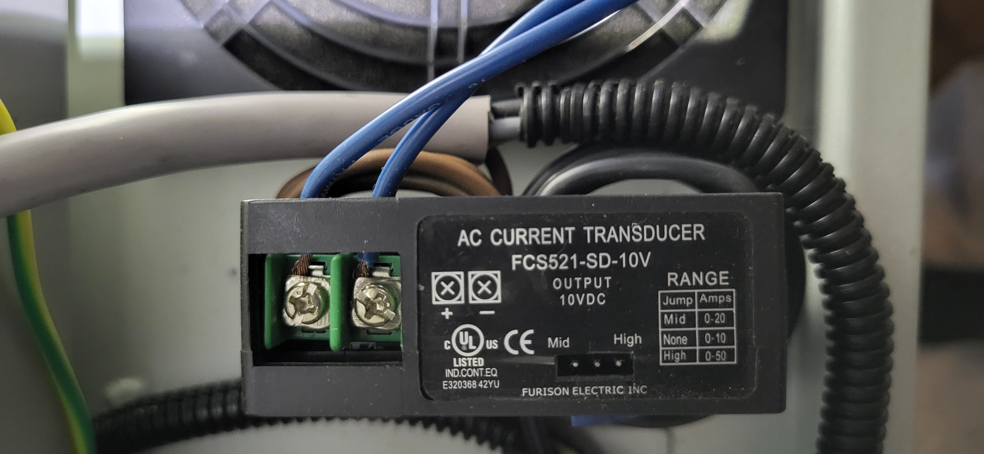

I was a little miffed the 770mx didn’t have at least an add on meter. So I added a current transducer and bought tormachs meter.
You basically wrap 1 phase through the magnet. 2 other wires feed the meter. It took a a little trial and error to get the number of winds right and it’s not exactly calibrated to the meter. But I have it close enough so I know when I’m approaching full load. By all rights you probably don’t need to or shouldn’t operate at max load continuously. These machines don’t like it.

![20260302_170105](https://forums.tormach.com/uploads/default/original/2X/1/19c19bb5d1d152bb1626d90e1e5e532a0ce9bf34.jpeg)
