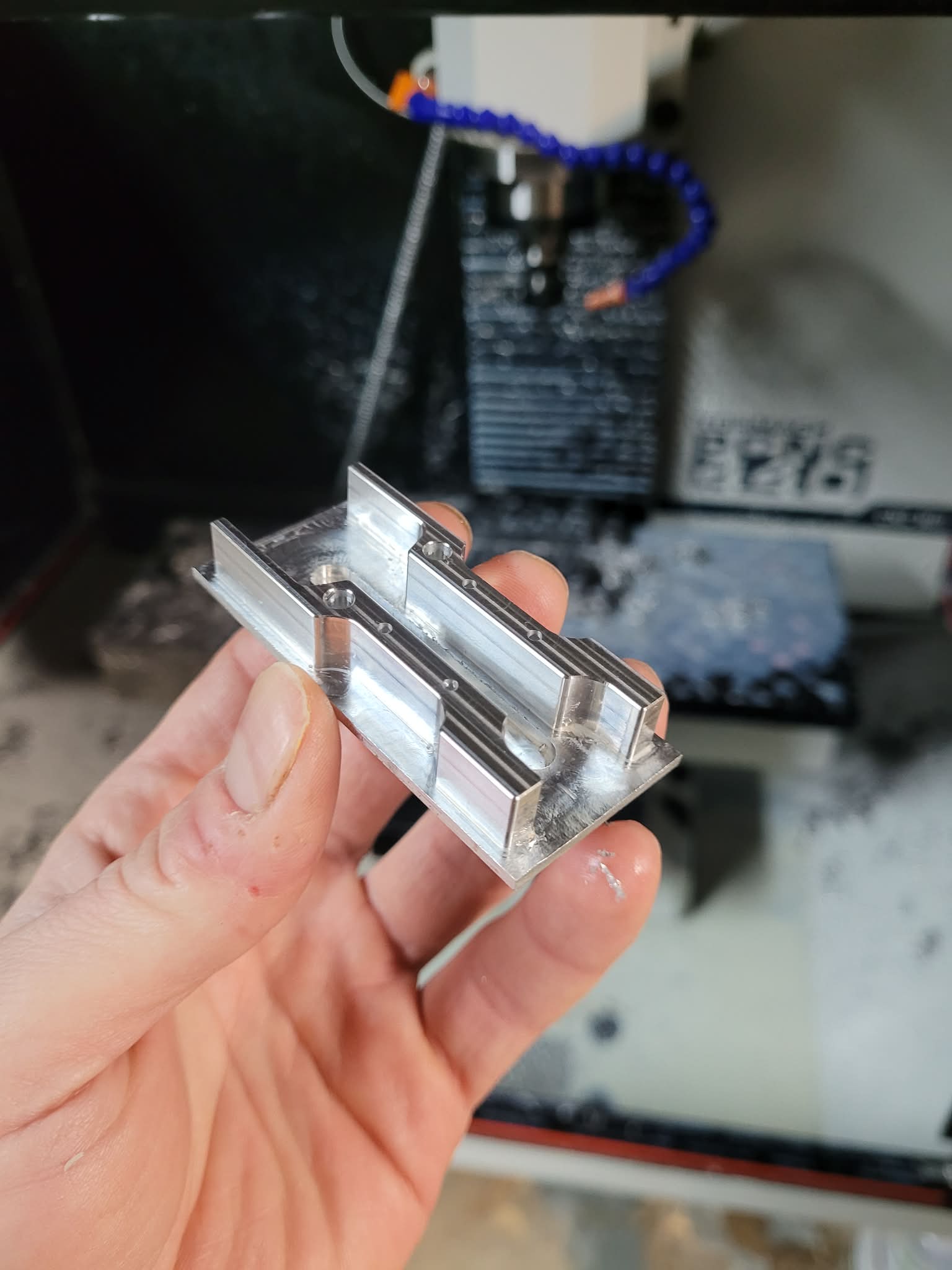

EDIT:
continued machining after this, and at the end of the program I lost X axis position.
I heard a strange noise on the X axis, and immediately after that my chamfering tool cut in the middle of the part, clearly indicating that the machine lost its X home / position reference.
No alarms or limit warnings were displayed.

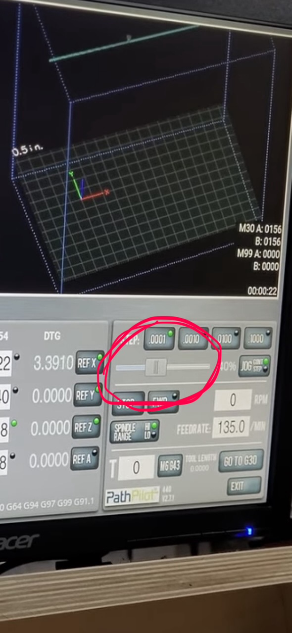

Your jog speed is set at 40%.
Push it up to 100.
I don’t understand why I didn’t realize that but you are 100% right, I will do the same test again at 100% thanks
The jog speed slider applies only to jogging with keyboard or pendant and does not affect G0 rapid moves. Rapid moves can be slowed down by max velocity override (bottom left of the screen), but that was set to 100% in the video.
Hate it when that happens
:laughing:
:laughing: I was feeling dumb because I didn’t realize it was at 40% and now I feel dumber not knowing it doesn’t matter ahah
