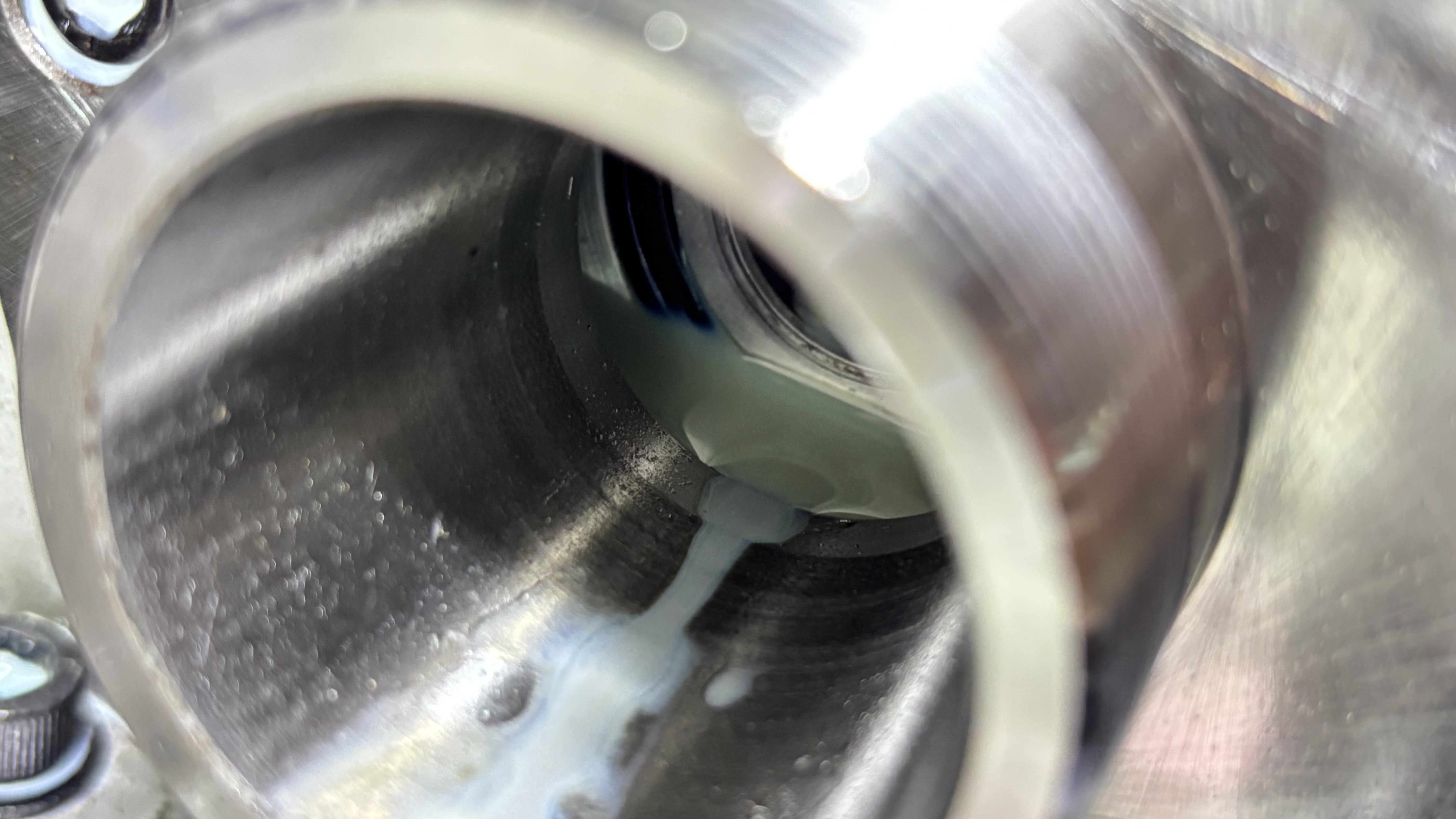

Just wondering about opinions on what to do and whether it’s safe (for the MicroArc) to let coolant pool
 ![IMG_0160](https://forums.tormach.com/uploads/default/original/2X/1/1454f929066389b4c735e54586708e965a2d9565.jpeg)
. It’s a bit of a pain to clean out and even after blowing the coolant out (which I am unsure is good because it removes the coolant or bad because the air blows coolant against and invariably into the seals) there will be more coolant there in the morning. So what is the recommendation to maximize MicroArc life. Do I even need to worry about the is?

@Dr_Harold_Jones
The MicroArc will not be harmed if coolant gets into the chuck cavity or the thru bore. A standard air gun is also not strong enough to force the coolant into the electrical box through the seals, so either cleaning the coolant out or leaving it be will not affect the unit’s lifespan one way or the other.

I have had a microarc 4 for 2 years in our shop. We remove it from the enclosure when it’s not being used. After sitting on a shelf for 4 months we set it up and found it to be stalled. Ohmed out the coils, all good. Swapped drivers, still stalled. Opened the microarc grey back cover and found the laminated body to be wildly corroded on the side and bottom. Removed the motor and opened it up to find AWFUL crystalized corrosion between the rotor and stator. Corrosion covered 360°, starting at the chuck side of the rotor continuing 1/3 of the way back along the stator. These steppers are not IP65. We removed the corrosion, oiled and greased it and reassembled. 2 weeks later seized again. Oiled, cleaned, greased again. New seals going in next time…
