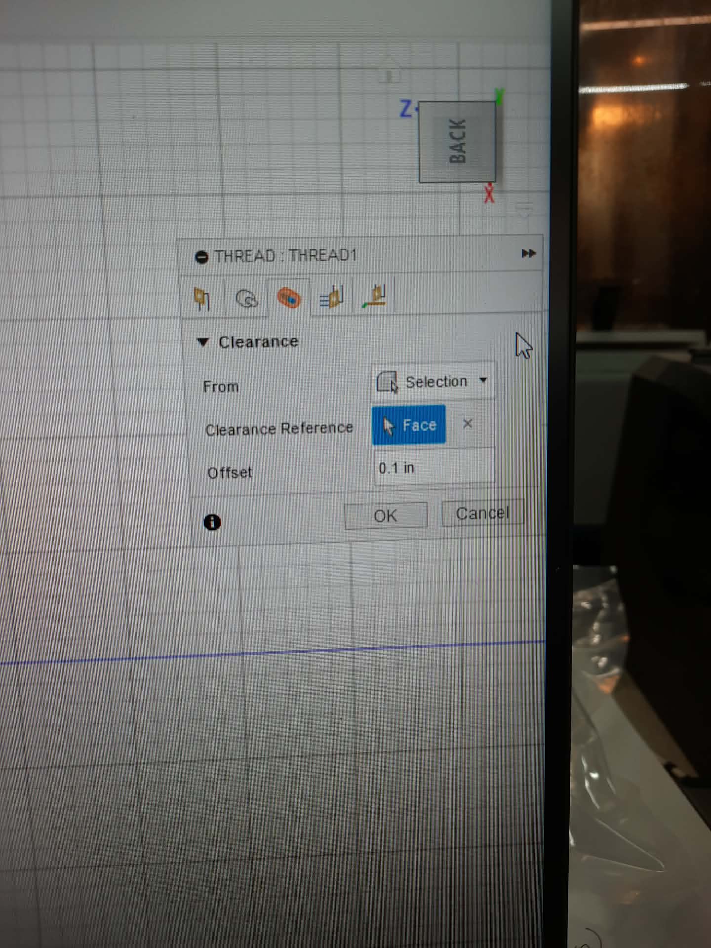

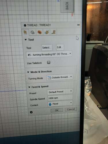

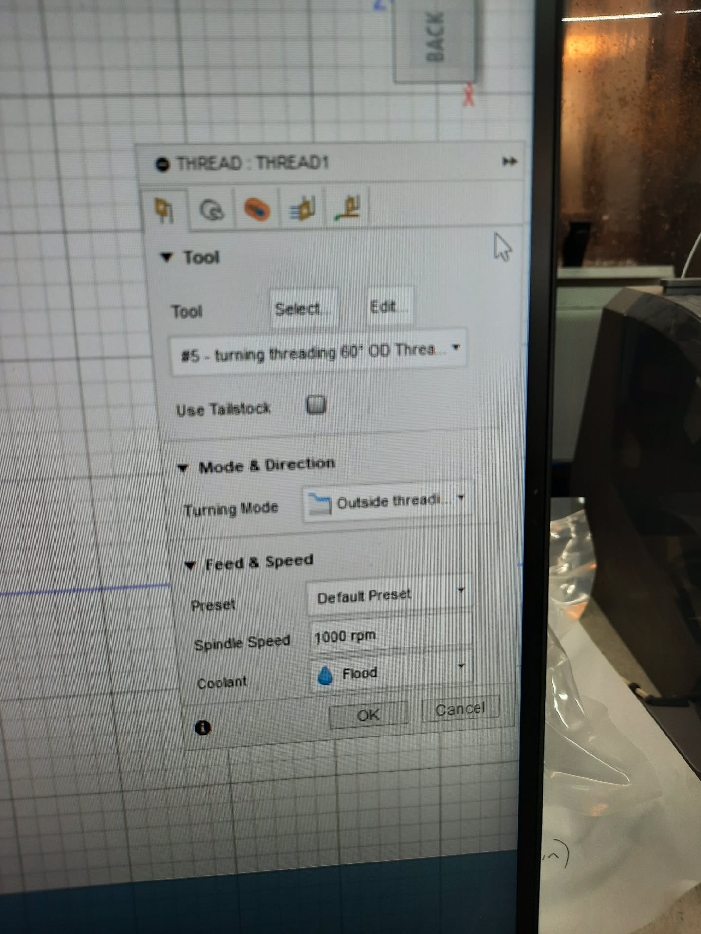

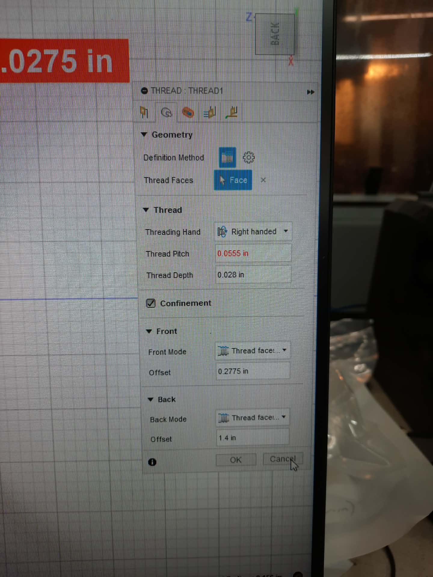

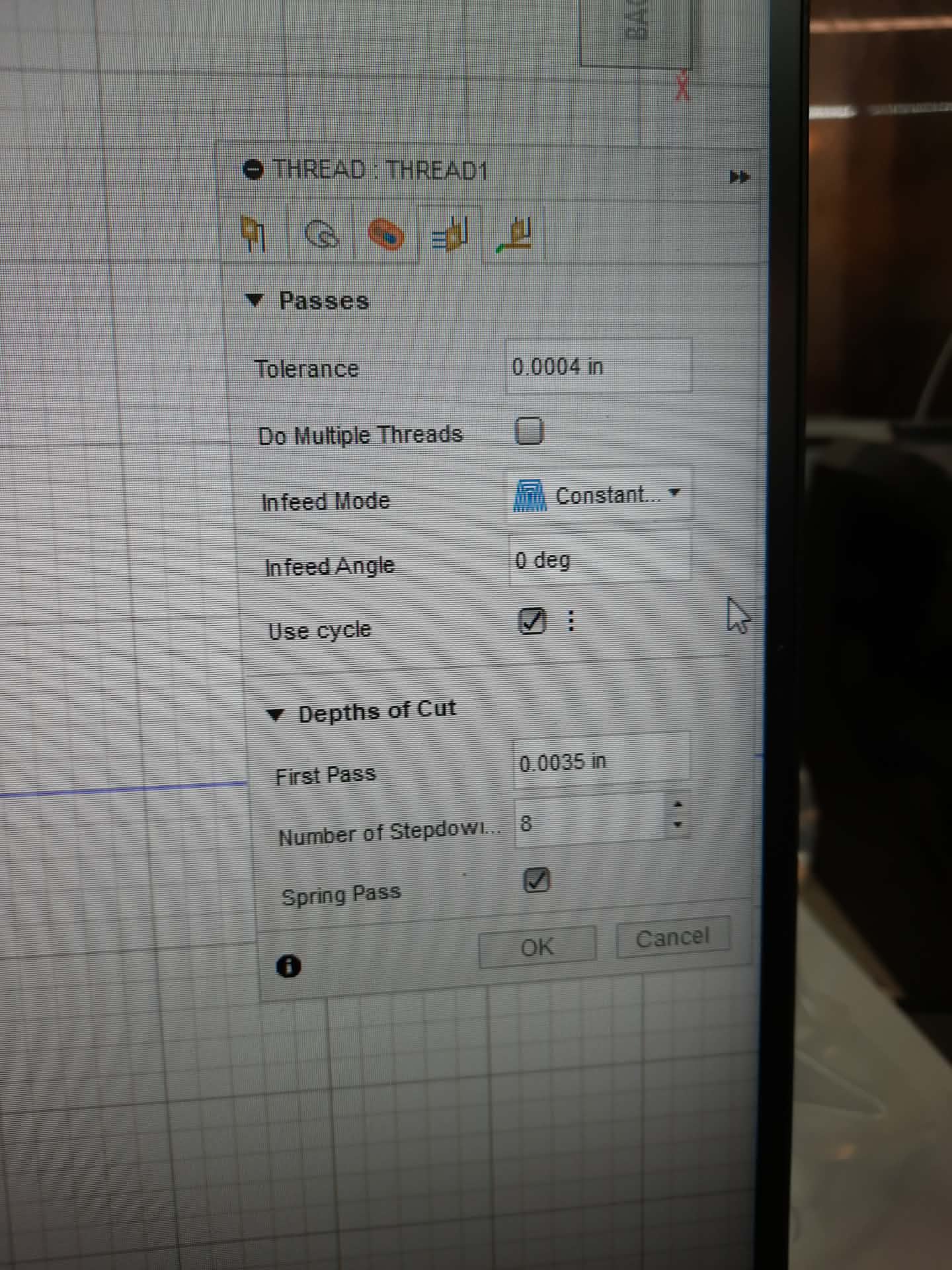

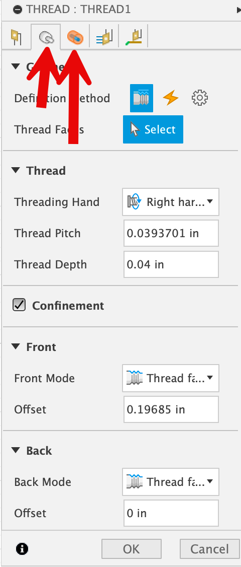

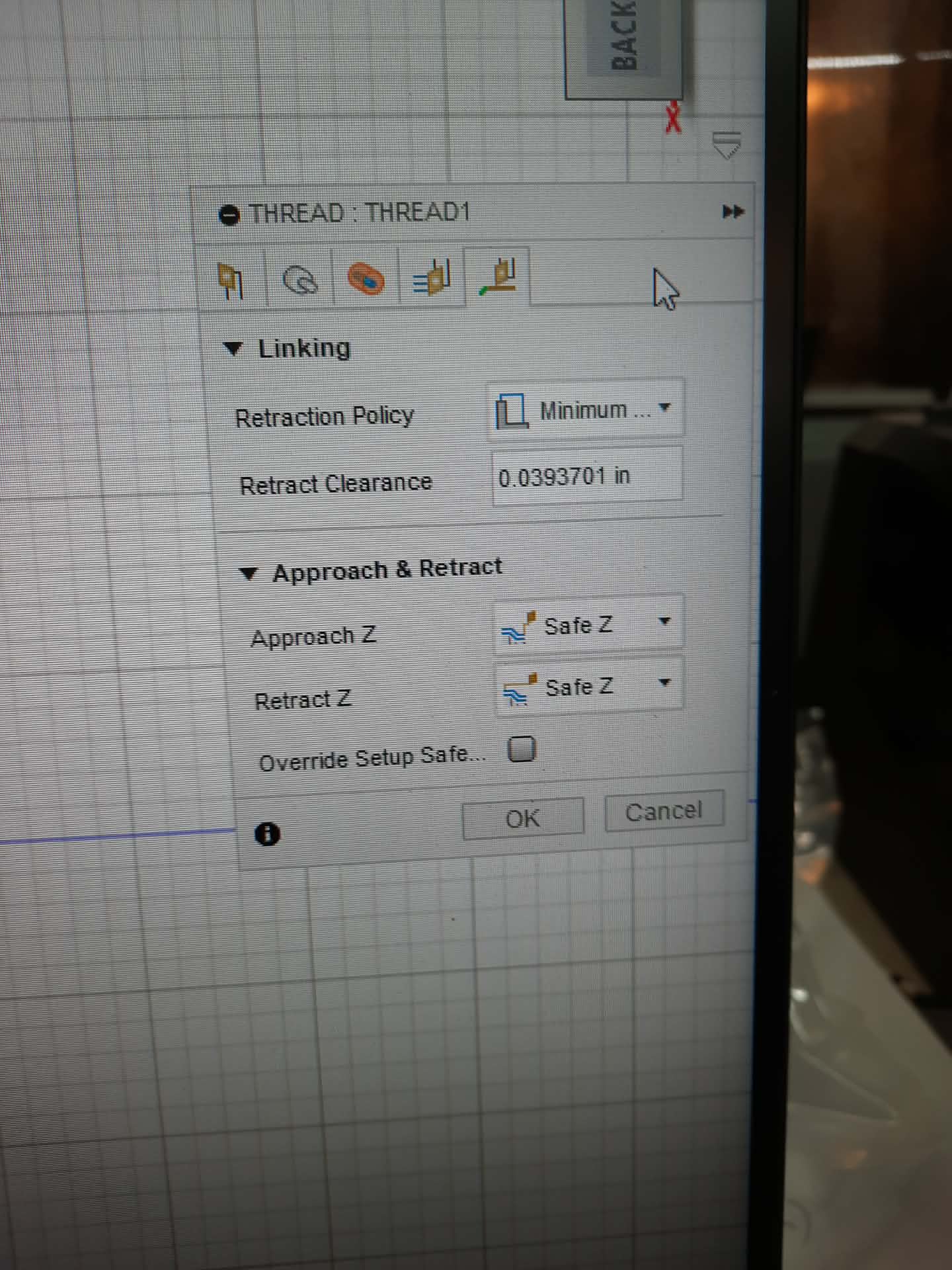

Here’s all 5 tabs for this step…

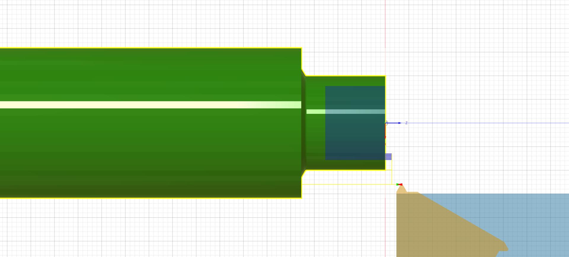

I use a product called Snagit for screenshots and annotating, well worth it…. I don’t see anything obvious there, can you screenshot your tool path preview illustration?
<div class="post-metadata">
**Author:** ![Jason\_Rye](https://forums.tormach.com/letter_avatar_proxy/v4/letter/j/cdc98d/32.png) [@Jason\_Rye](https://forums.tormach.com/u/Jason_Rye)\
**Post date:** [November 3, 2025, 8:37pm UTC](https://forums.tormach.com/t/8l-makes-an-unusual-move-pre-threading/2793/10 "2025-11-03T20:37:30Z")
</div>
I can, but let me say this first…it previews correctly. It does approach at the X0.5125, but then drops in to the right location and cuts the model in simulation exactly as it should. I’ve done this step-by-step single-block style in simulation. We’ve just taken to removing that line before running the program, but something’s not right.

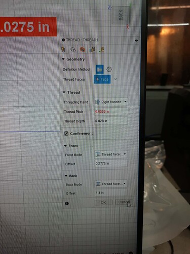

![8l handle v1 v8 A](https://forums.tormach.com/uploads/default/original/2X/1/1b52625b64d833a54a6dcef9e760c308b4d729d8.jpeg)

So strange…. I wonder if it’s in the post? Have you had someone else try to post it or do it on a different computer?
